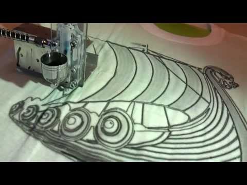

This below could be adapted. You could get one of the programmers here to turn the z axis into a trigger pull to essentially paint. Good luck.
is this real-time? i would like to make this on my maslow but there is gonna be some tinkering with the “paint-output” because the maslow (mkII) is way to slow now to not let the paint drip. great idea tough
