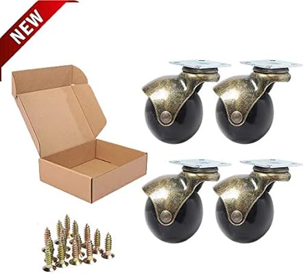

Had identical wheels to these on hand. The ball wheel works better in this tilting mechanism than standard circular wheels.
