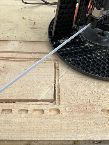

So I’ve started making some cuts but struggling with the consistency. I’ve a gcode that has some small pockets but the machine is not cutting well.
I’m finding that after calibration (fitness of 1.05nnn) I’m getting situations where the cables appear to loosen. I’ll reset the machine (full power down, retract, extend, apply tension) and it will work for part of the cut, then cables loosen and system will stop. I’ve had this occur 5 times this morning.
And suggestions as to what is going on? Pictures and gcode attached.

Bar is working on some things, watch for a mid-week firmware update.
You might try increasing the current threshold and let us know if that helps.
I’ll push it up to 1500 and see what happens.
Updating to 0.72.1 might help too. Generally working on making the belts tighter is my current focus :slight_smile:
maybe try lowering your plunge rate, see if that helps?
Also what kind of bit is that you have installed?
1/4″ Carbide Compression Bit from cncbits.ca
hmm. I never used that type before have you? Looks like they require a dialed in toolpath and other considerstions to use correctly over a more simple endmill.
Bit of an update - 0.72.1 appears more stable; Not encountering the same issue as before. The cables appear to be a lot tighter than previously. Cut is running now - hopefully I can share a successful run later!
Thanks all for the suggestions and Bar for the FW update!

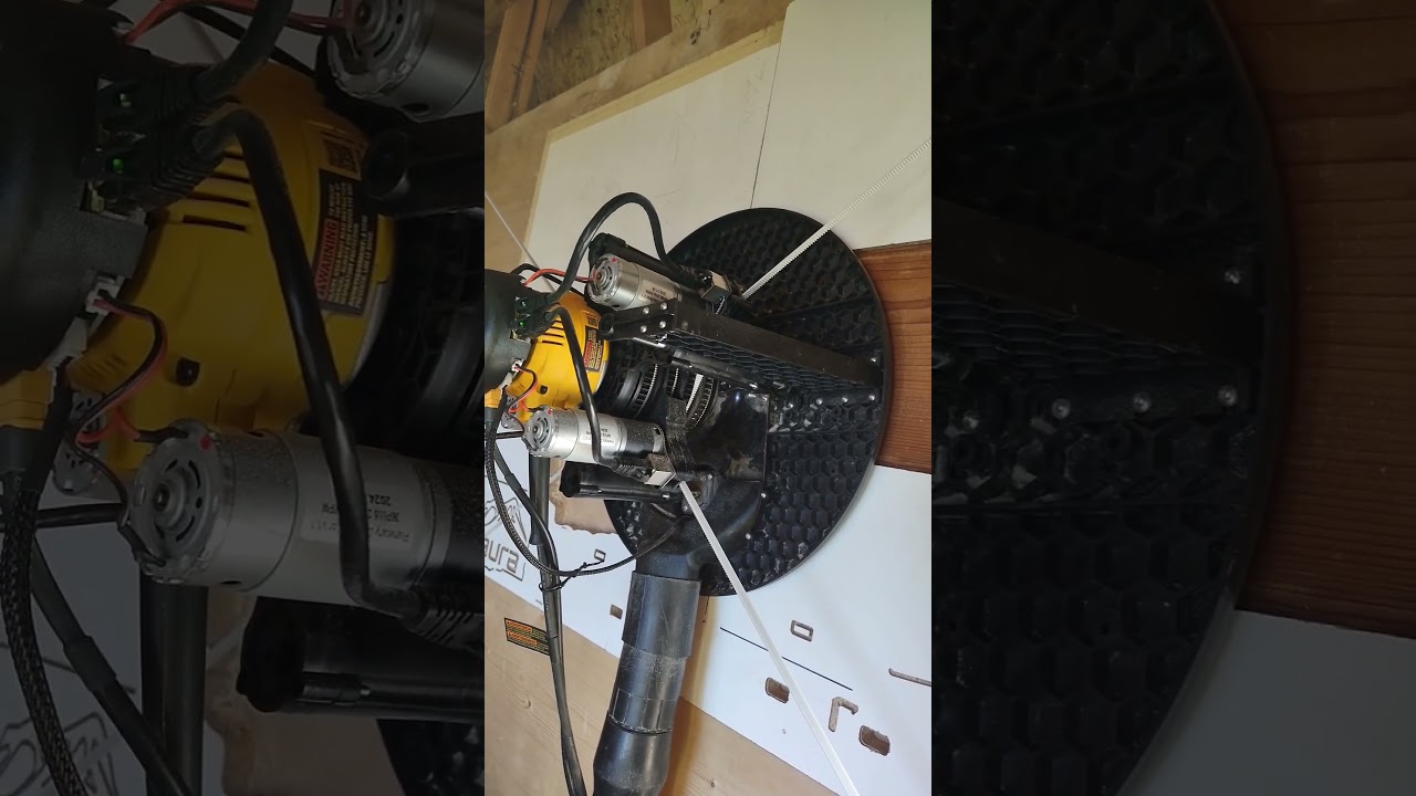

Good news. I was able to get v.78.1 working but I can’t seem to figure out the plunge issue.
It seems to find it’s location just slightly above the cutting area, plunge and then drop into the pocket. See photos above and video below.
The video stinks bc my had shakes but if ya watch carefully it will plunge and then move down when it reaches its depth.
The command was just to jog to the location and plunge a few mm.
Any ideas??
