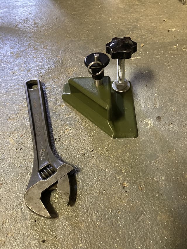

I quickly tired of screwing and unscrewing my Maslow belt ends from their anchors during the retract, extend, calibrate sequence and went looking for a better solution.
I have a horizontal setup on a flat concrete garage floor so drill in / drop in anchors were the obvious way to go. Naively I thought a simple 10mm bolt into these would do the job… nope. I quickly came to realise that you need to take the belts on and off the anchors. I’ve suffered through two dead z axis control boards, which failed after I had calibrated the machine.
So I was unscrewing the bolts a frustrating amount of times.
Thanks to the ‘not shop’ and the forums I could see a potentially better way by using a combination of the ‘Fancy Locking Pins’ and the ‘Triangle Anchor’ from the ‘not shop’ and ‘drop in anchors’ as described in the forums.
This required a new design modelled on the ‘triangle anchor’ but better suited to being firmly bolted to a drop in anchor on a concrete floor. I also needed them readily removable as the garage needs to be used for other things - or so I’m told
This is the somewhat satisfying result
Apologies for the poor framing of the video - I only had two hands and an old cardboard box to hold everything

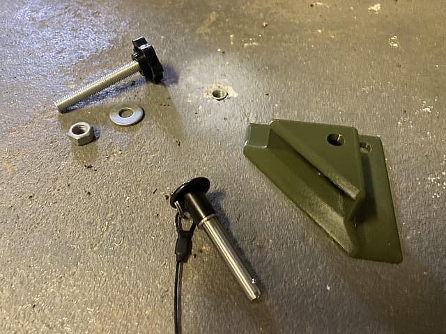

The parts are simple and low cost
I got the pins and bolts from Ali Express at about $25 USD for a set of 4 of each delivered to here in Australia
Assembled they look like this
I was concerned the mount may move / pivot around the bolt into the floor under tension from the Maslow, but no, when the floor bolt is nipped up tight its solid and doesn’t move an iota.
You do need access to a 3d printer or 3d printing service and a few hours of print time per mount
With the large overhang you need to print with supports enagbled and have a few minutes of
clean up time when you are finished.

Pins: VCN011-10 with rope, 40mm
aliexpress Quick release pins
Knob Bolts: M10 (Head 38mm), 70mm (2pcs)
aliexpress Knob Bolts
Mount: (3D printed)
CAD: Onshape link
STL: STL file on Github (from Onshape)
3MF: 3MF file on Github (from Prusa slicer)
