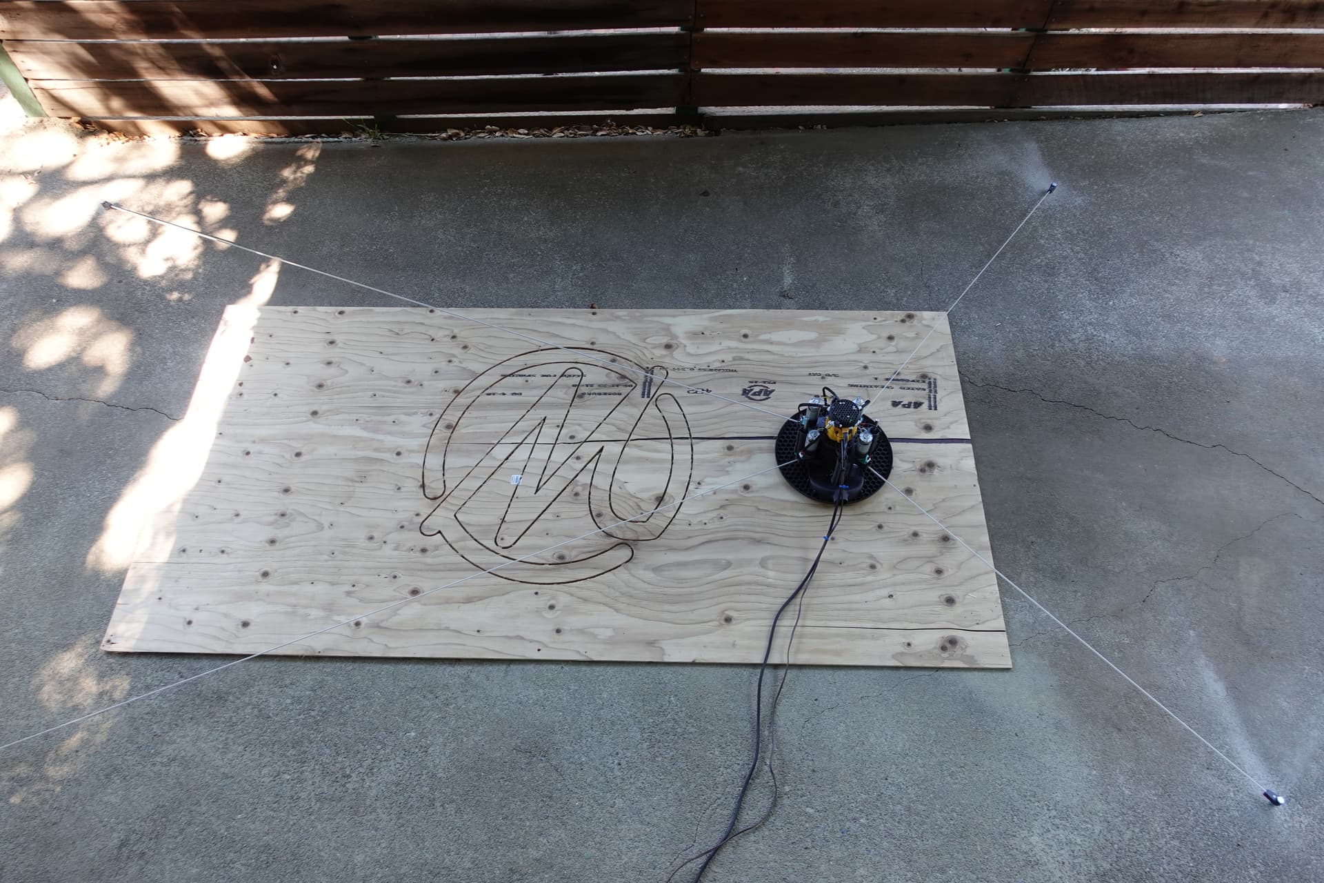

I gave it a shot today with the Sammy’s anchors that I already had and other than the fact that they leave a bump that protrudes when they aren’t in use, they work great.
I don’t have a garage right now so it was just in my driveway which I am absolutely positive is safe to drill holes in :grinning:
Edit: full disclosure I didn’t cut that M outside, that was done earlier on the other frame. It was just a piece of plywood that I had laying around so I threw it down to play around on.
