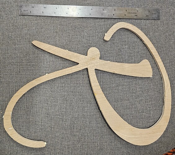

Here’s what to me was the impressive part…I was able to look at the start of the serial logs where I defined the home coordinates. I power cycled the M4, did the retract/extend/apply tension, then jogged to the previous X, Y, and Z coordinates, clicked Define Home, and ran the file again. I could barely hear the router bit cutting wood until it got past the point where it failed, and I think the cut turned out well. Script R, also for the logo for my wife, 12" ruler for scale:
I think I put way too many tabs on that one. I’m cutting in the horizontal orientation and making shallow cuts, so I don’t think I need much in the way of tabs.
