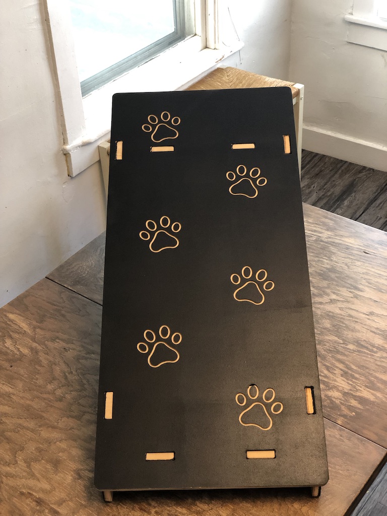

Here is my first cut project after building the sled and Meticulous Z axis upgrade (still need my dust chute) I made a ramp for my 6 year old Basset Hound Rosco to use while he is recovering from tweaking his back. On Dr.s orders of no jumping or running so this will help him a little. 1/2" MDF (well that cuts way different than ply. broke a bit) covered in a rubberized paint followed with grip texture paint. Ended up with out enough traction so I am adding a rubber nonslip pad to the top but here it is.
I also moved the bricks from the bottom location as I felt they were too low and off balancing things. I moved them up as seen in the pics which balanced everything nicely but caused the sled to rotate slowly requiring constant attention.I had to re cut a piece du to a broken bit and a crap chinese spare I had (never again) Final solution was to move the bricks back to the bottom but mount them perpendicular to the sled, worked great with a new bit and the relocated bricks.

At first I had the weights on the bottom below the Axis kit (pointed straight down) I felt they were causing too much drag and counterweight to the sled making it off balance on the lower end of the cutting area. I moved them to the top to try and get a better balance and center of gravity. Moving them up top balanced great but caused the sled to rotate as it moved laterally. I did relocate them back to the bottom of the sled but positioned them perpendicular to the axis kit, this removed the potential for rotation and did not off balance the sled or mess with the center of gravity (I just didn’t have a picture of the final arrangement).
