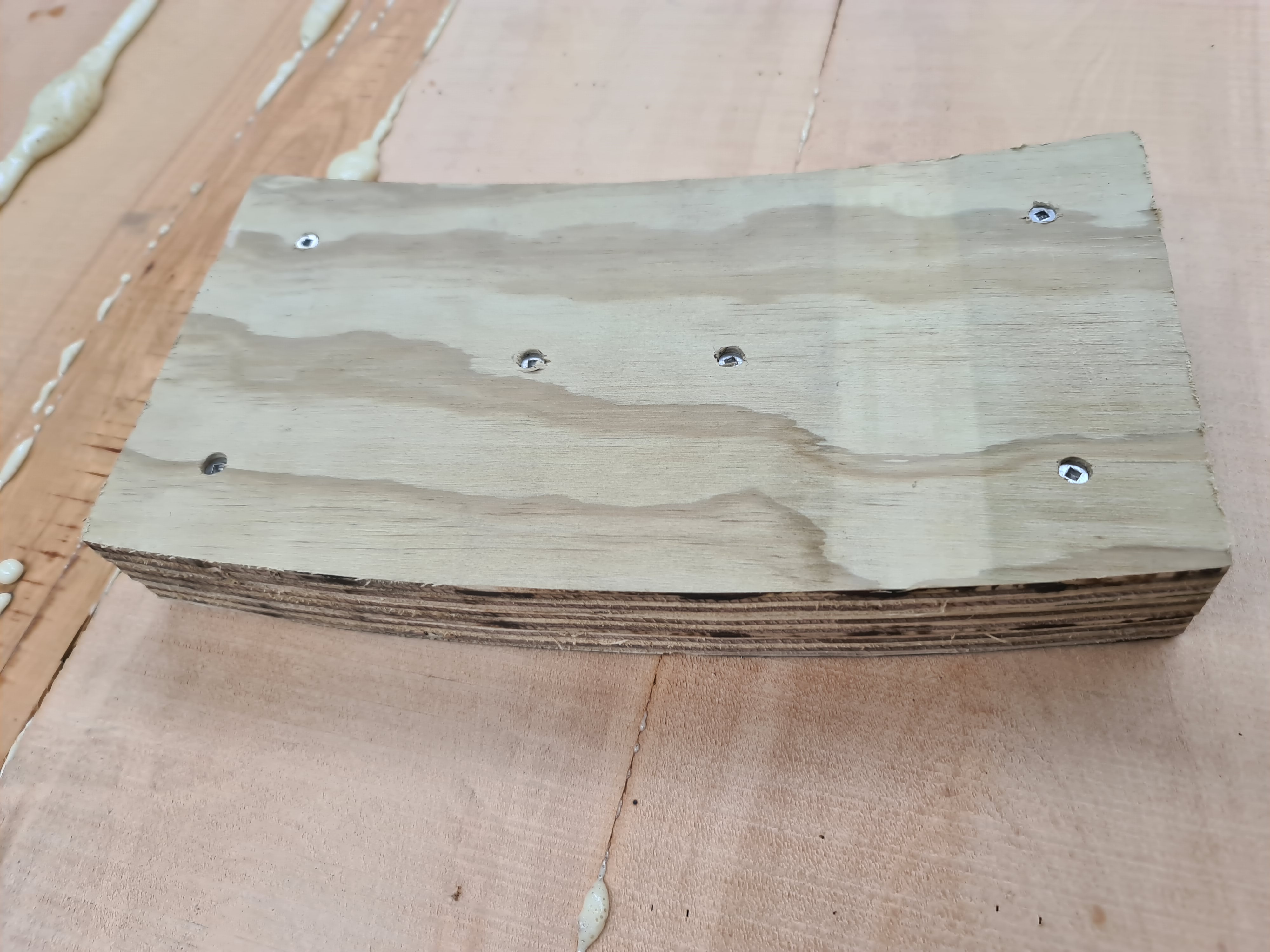

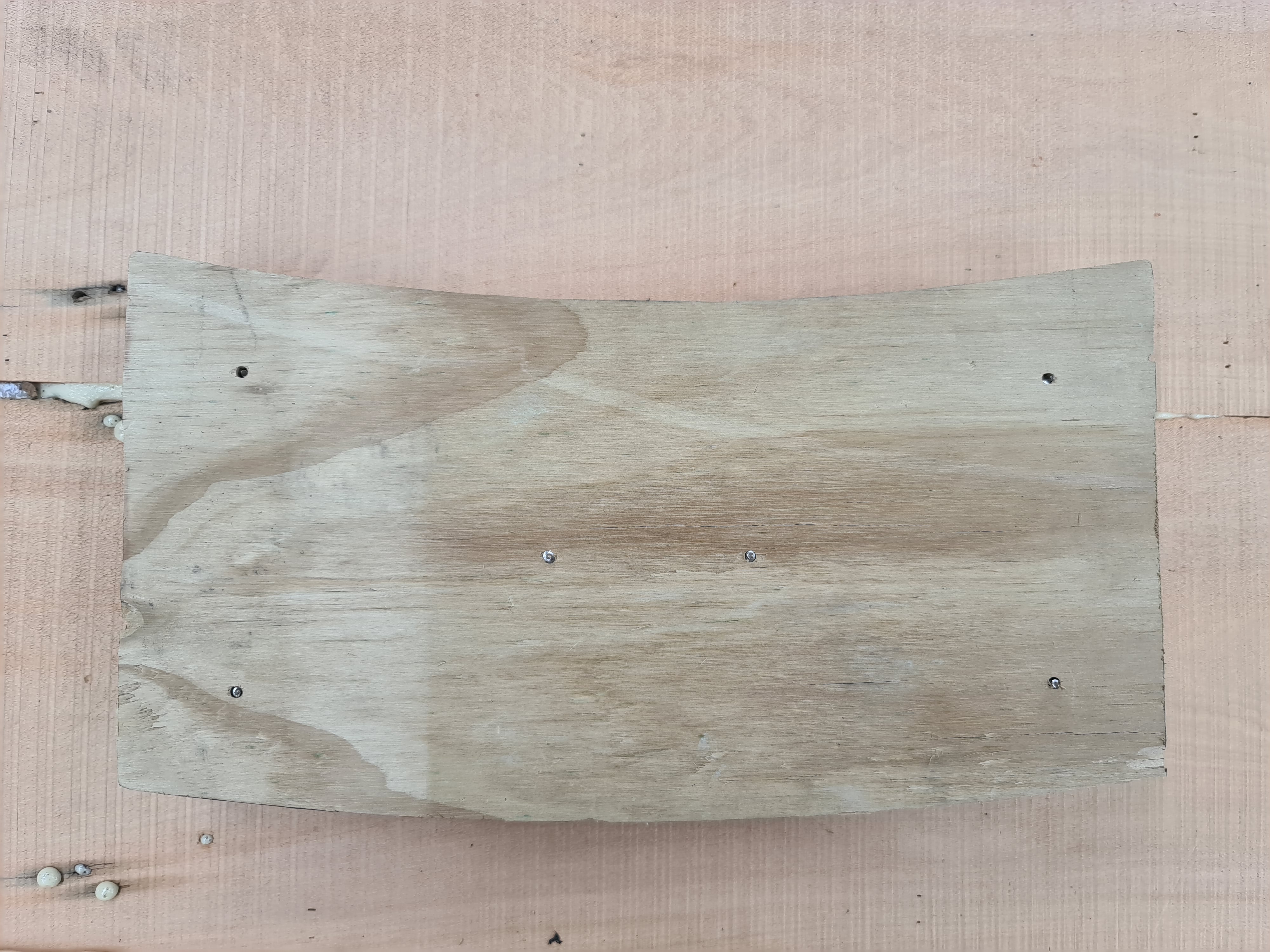

So I have now put 8mm uhmw on the sled bottom (couldnt get any teflon locally) and added 4lbs of steel to base as well to bring it up to 27lbs total weight. Cut my test frame join for my glasshouse in the extreme bottom left corner( right on the edge of the sheet. First photo is from the original frame second is from my new frame. As you can see the screws are coming out the pilot holes on the other side so I’m very happy with the accuracy!
