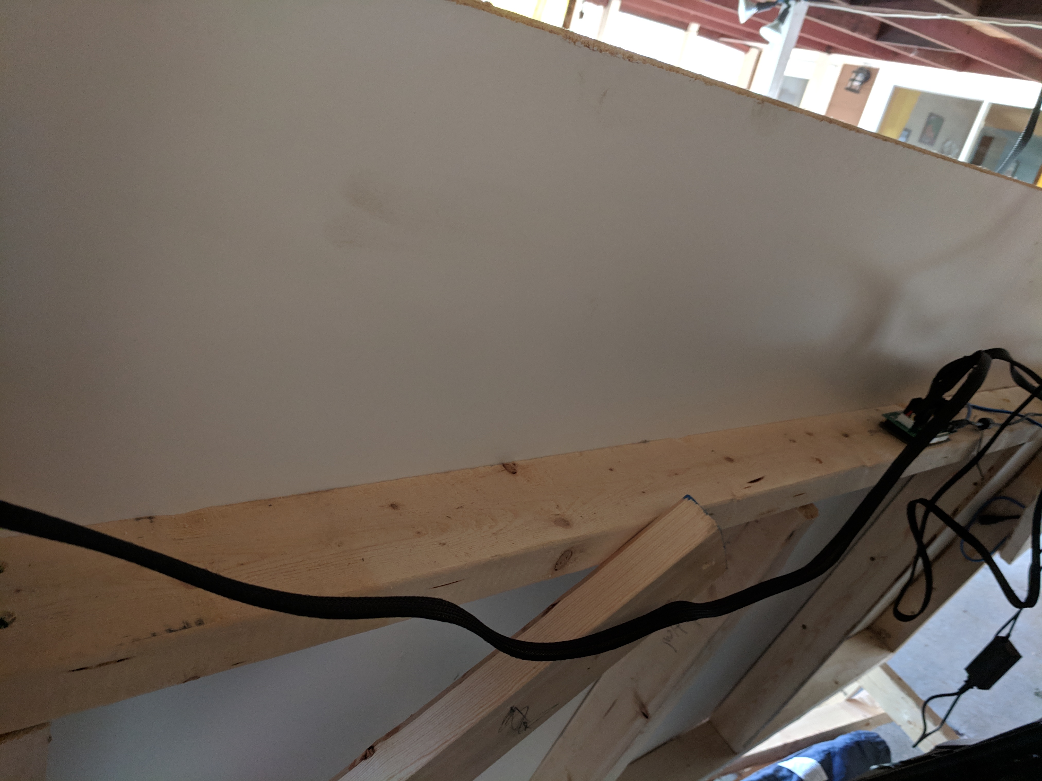

The other issue I’m having now is keeping the motor cables securely plugged into both the motors and the motor shield. Does anyone have any recommendations on how to hold these in place?

can you show us a picture of how you have things mounted?
I would use a wire tie or cable clamp of some sort to hole the wire a few inches
away from the connection so there isn’t any stress on the connection.
They should be static/not moving, if you have movement in them, there must be a reason. With mounted motors and the shield and cables away from chains and sled, there is no reason to secure them (z-motor cable should be secured). Anyhow, a drop of (not too hot) hotglue would hold them and allow to be pealed off in case a change is required.
I’ll dig up my wife’s hot glue gun. Do you think there’s any harm gluing the connection? Or should I just glue the cable to the top beam?
Again, there should be no reason to glue them. Eliminate the reson why they come loose is better then gluing and a glue-gun can damage the connection. It’s a extreme measure that should not be needed.
If you do it, do not touch the connectors with the tip. Rather let a small drop a drop from above.

I’ve checked, I don’t have any photos on hand of my setup, but I can try to get some later tonight.
In a nutshell, I have the Arduino/Shield mounted in the center of the upper front cross member of the default frame and the motor cables are running out to their respective motors.There’s a bit of a drop from the top beam to the upper cross member, but I cannot imagine its enough to be pulling a cable loose.

For those that requested photos of the setup to help diagnose:
I’m going to take @dlang 's suggestion and put some cable clamps on the cables a few inches from the motors, leaving a bit of slack between the clamp and the motor. I’ll be damned if I don’t have a stash of those in my basement to use on a project just like this.
On similar things I have had good results with hot melt glue. It is nice because you can crack it off later on if you need to but it sticks pretty well.
I handled my cables a little different. I put hooks and cables ties for the XY motors near the controller board in case they got snagged, they would not cause damage.
The Z cape is hooked over those hooks so I could unplugged, so if I had to remover the sled for any reason. I hooked a weight on the cable and over the 2x4 to get to the router. The weight keeps it out on the way when the Maslow Is running. On the router I used more cable ties to keep to out of the way and from becoming unplugged.
Where it comes over the top 2x4 I need put some kind of guide to keep it from tangled is the buggy cords. This is still a work in process.
Marty
I’m definitely going to be anchoring my Z-axis cable to the ring!
The weight of the portion of the cable that is draped over the waste board itself seems to take care of removal of slack.
Zip ties seem to anchor it nicely to the ring supports.
