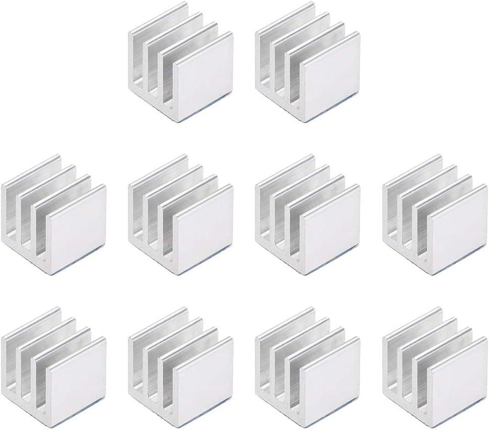

I finally got what I think were heat sinks larger than provided, with more surface area, and providing clearance under the fan… Digikey ATS010010010-SF-1I. They needed thermal tape added. Shown is the new sinks next to the provided, and installed on the motherboard.
I should be able to start making some dust soon.
Looks like these are 10x10x10mm?
Can you confirm?
As there are plenty on Amazon.
Example:
Thank you!
Geo
Those look like the same size as what fit in mine and with the tape already applied. Great find! I went back to Amazon and searched and they came right up. Not sure why that didn’t happen the first time. AI has its ways.
