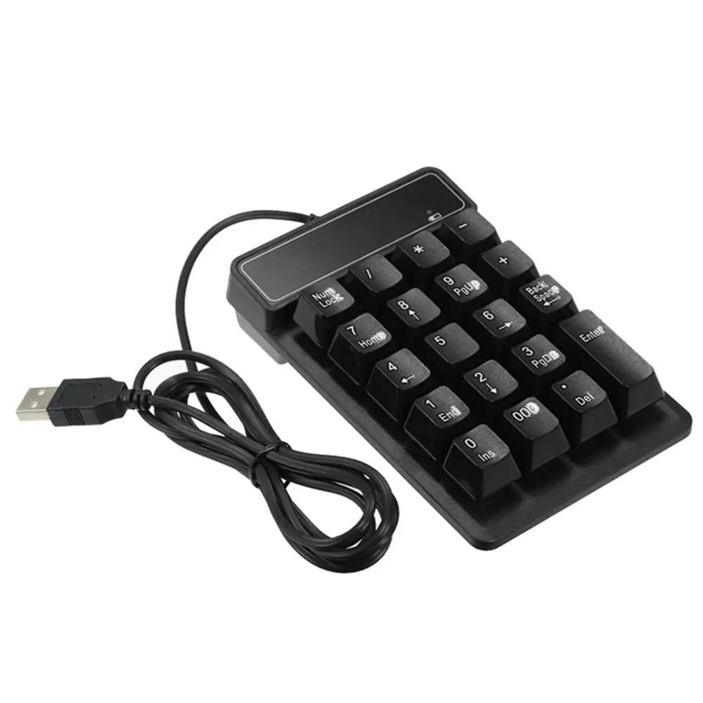

Did anyone suggest a numeric keypad? Small. Cheap. Wired.
If you can control Ground Control with a keyboard you can control it with a numeric keypad. No drivers. No latency.
