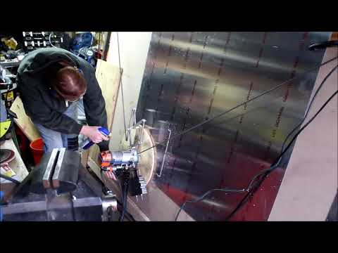

@MeticulousMaynard posted a video a few years ago doing just this:
Funny thing is, I was just working on that video in YouTube studio recently playing around with music.
Aluminum is within the realm of possibility, but it certainly is slow. After a lot of testing and breaking bits, I came to 400mm/min (15ipm), 12000rpm, with 0.5mm (~0.020") stepdowns for my single flute 1/4" bits. I was cutting 0.040" 6061 sheet, so it took 2-3 passes to cut all the way through. Cutting fluid is a must, or you’ll get aluminum galling itself to your tooling. I used WD-40, which works in a pinch, but proper cutting fluid is better. It wouldn’t be too hard to rig up a mister setup on the machine if it’s consistently cutting aluminum.

We cut ACM sign board on ours quite regularly ( acm is a 4mm plastic with .5mm aluminum bonded each side . ) we cut it dry with 3mm cutter. But it does have a habbit of bonding the aluminum to the cutter end with every plunge cut.a ramped cut start seems to help.
There was someone before me who did it, back in the early early days. Can’t remember now, but they should have replied to the thread I made when I posted that video.
And Tricordial milling (also known as Volumilling, among a myriad of other names) is great for milling machines but I doubt the Maslow can handle the chiploads typically used for it. I’ve used that programming technique for both steel and aluminum on full sized cnc mills and it works wonders. I could reliably take off a 1/2" of steel each step down and could get parts done crazy fast.
I could definitely see the Maslow being able to handle ACM. With the right settings, that stuff cuts great!
