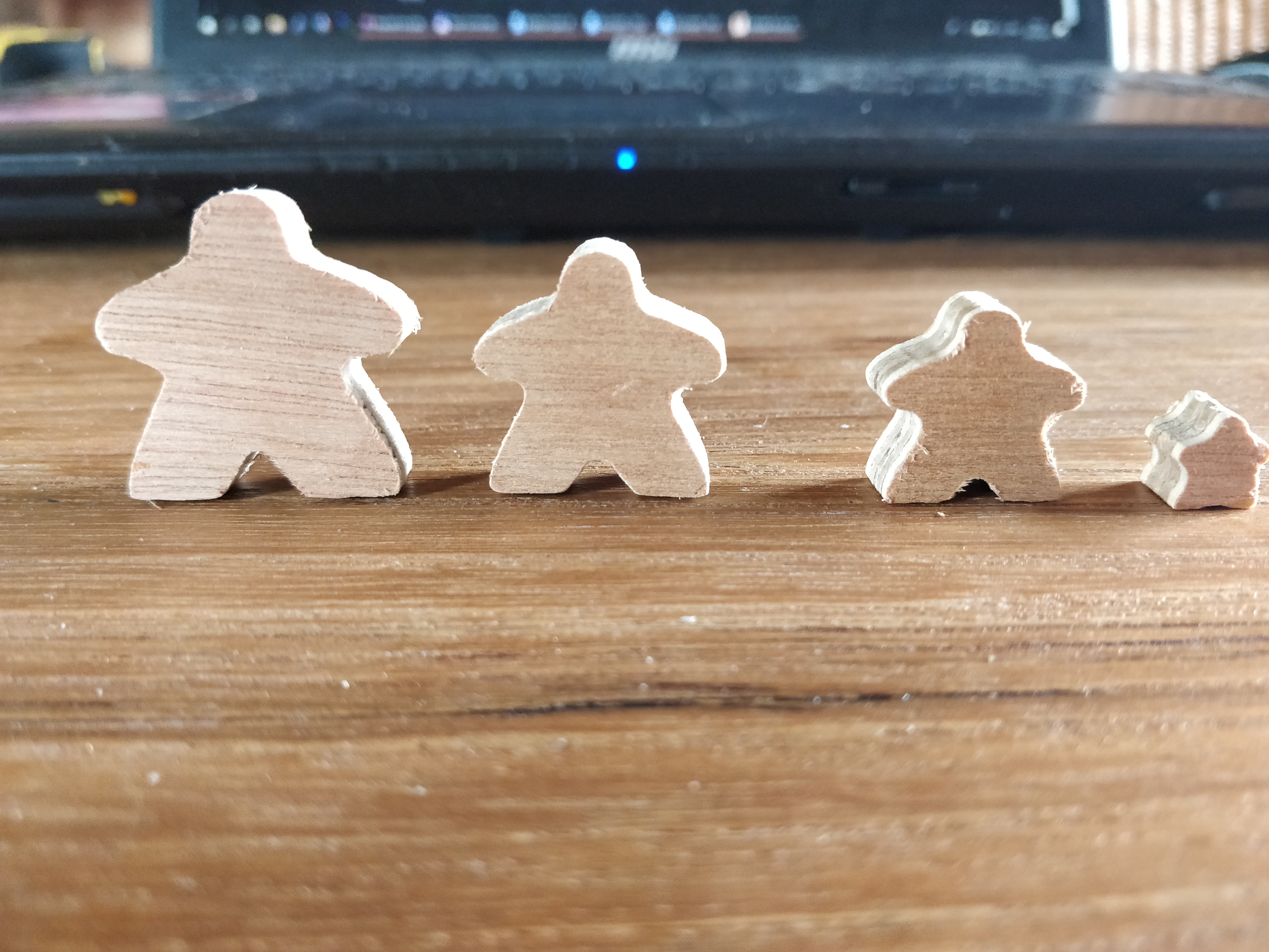

i’ve cut 5mm holes with a 3mm bit, and the holes were exactly 5mm. Don’t know if that’s a good test, but i find it adequate.
A jigsaw puzzle requires a jigsaw, even the smallest router bit leaves too big a kerf.

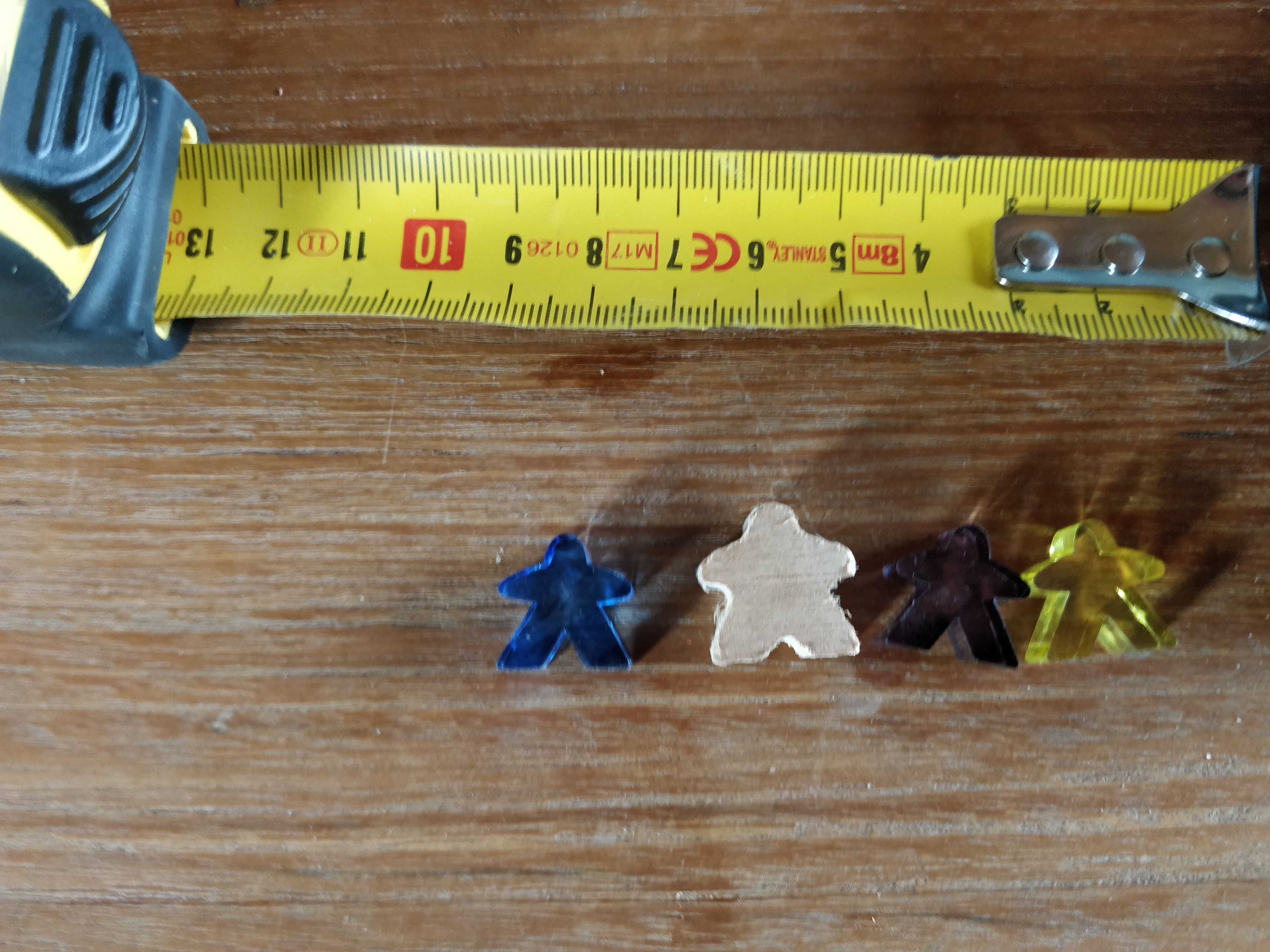

I’ll try some meeples later, sounds like fun. I allready made one, but it was before the maslow and didn’t need much small detail :slight_smile:
Also keep in mind the material you want to use. Depending on that and how sharp your bit is you could get some tear out near your cuts. I tried doing some smaller detail with plywood (crappy plywood) and I had so much tear out that pieces fell out, ripped out or wood fibers lifted up making it not very pretty.
Damn, i was very susprised at how well it came out. You should put some double sided tape on the back, just so the pieces don’t fall out, they are too small for tabs.
Also just realised that you asked for catan, but if meeples work, simple houses should work as well.

Great, now i feel the need to make a few sets of meeples in different wood types for the different players. I hardly even play carcasonne any more, but it would look nice in my display cabinet. Thanks a lot, like i didn’t have enough to do allready.

I’ll try finding a smaller bit to see if i can make the pieces smaller
