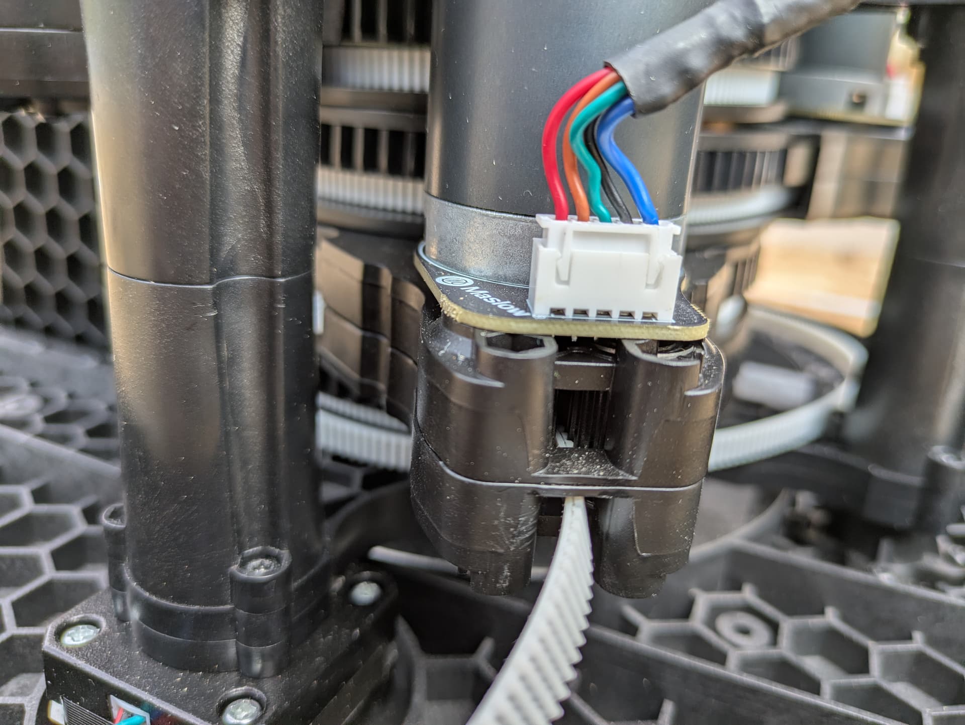

May be a different issue, I uploaded on my other thread but just in case here is the serial from a run where the machine reported that it was in the middle of calibrating and was maybe successful but then started to draw in the belts in with no command untl they broke and it fell off the waste board trying to pull itself between the last two anchors. It was doing this movement after it had reported calibrating calculations.

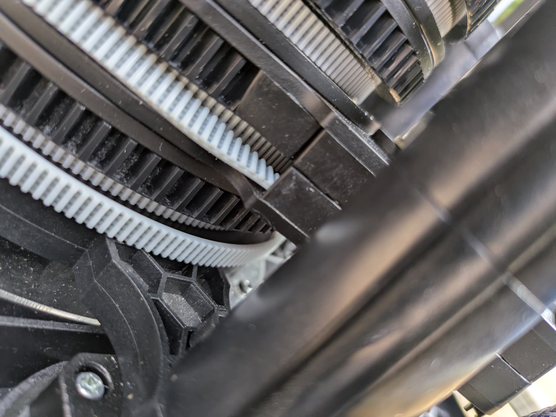

update, going to tear the whole machine apart it looks like one of the belts flipped itself over in the gears? weird. There was no twist in the belt when I attached it.
I believe that Bar replied to you that the firmware detected you had a frame larger than the defined max, and instead of stopping, it redefined the frame to be no larger than the max.
as a result, it was trying to pull the belts, thinking that it needed to pull them in more than it really did. And the torque of the motor was enough to snap the belts.
