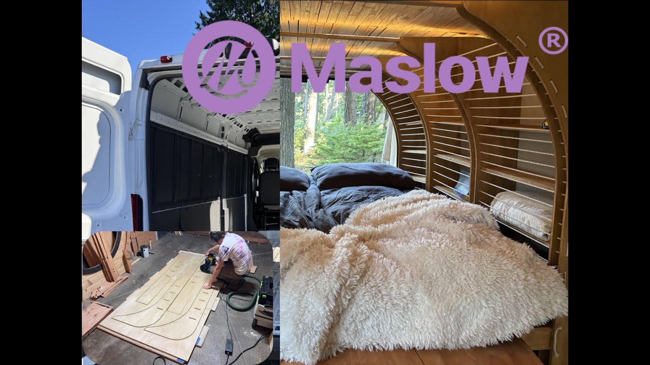

I did a 24 hour van build in a rental van that was a lot of fun and I promise to share pictures of all the best CNC cut stuff that I see!

@bar , amazing build. Thanks for creating and sharing your fun crazy fast rental van build-out video…
Impressive demo usage of your CNC, and Abundance project at abundance.maslowcnc.com/BarbourSmith/Van-Build too. Lots of neat ideas, like the rope shelves, zip tied roof, and 3D pan carving with standoffs for sled support.

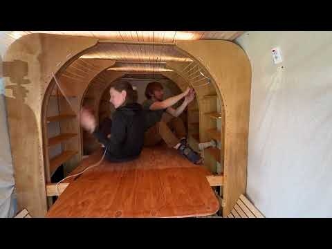

What was the increased current value (to avoid missed Z steps) that worked for your full depth 1/2” cuts at 2000mm/min (33mm/s)?
Did you do the full size bed cut at 2000mm//min too, or slow down since going close to edges of the full sheet?

I bumped them up to 1.3A for the run_amps: 1.300000 setting
That was the same speed :grinning_face:

I’ve been saying for years that you are extremely conservative in your cuts :slight_smile:
for your full-sheet cuts, did you check how far off they were from what you
planned?
I was hustling to get it done quickly so I didn’t take any measurements :confused:
