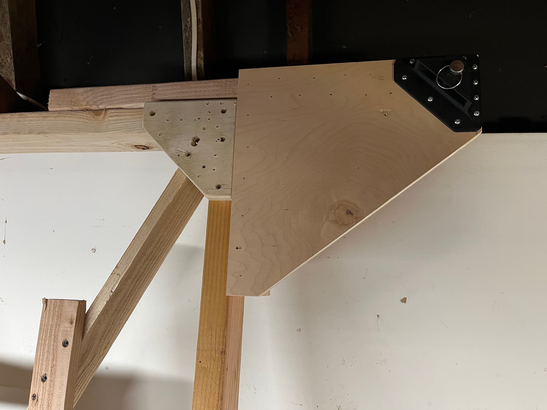

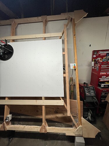

Don’t wan’t to hijack this thread too much but this is exactly what I’m testing. Trying to put some real numbers to the accuracy of the layout simulator. Still have 3-4mm error at the edges within the green area.
With a 1’ extension on each side of the X axis the motors no longer hit the frame. I tried the chopped ears but there was way too much flex in the machine.
Is this extending out the mounting points or belts or both. What did use to extend the belts?
Nice to hear it worked, looks good too.

I built little T shaped attachments and some 3/4 ply on top then screwed them to the frame.

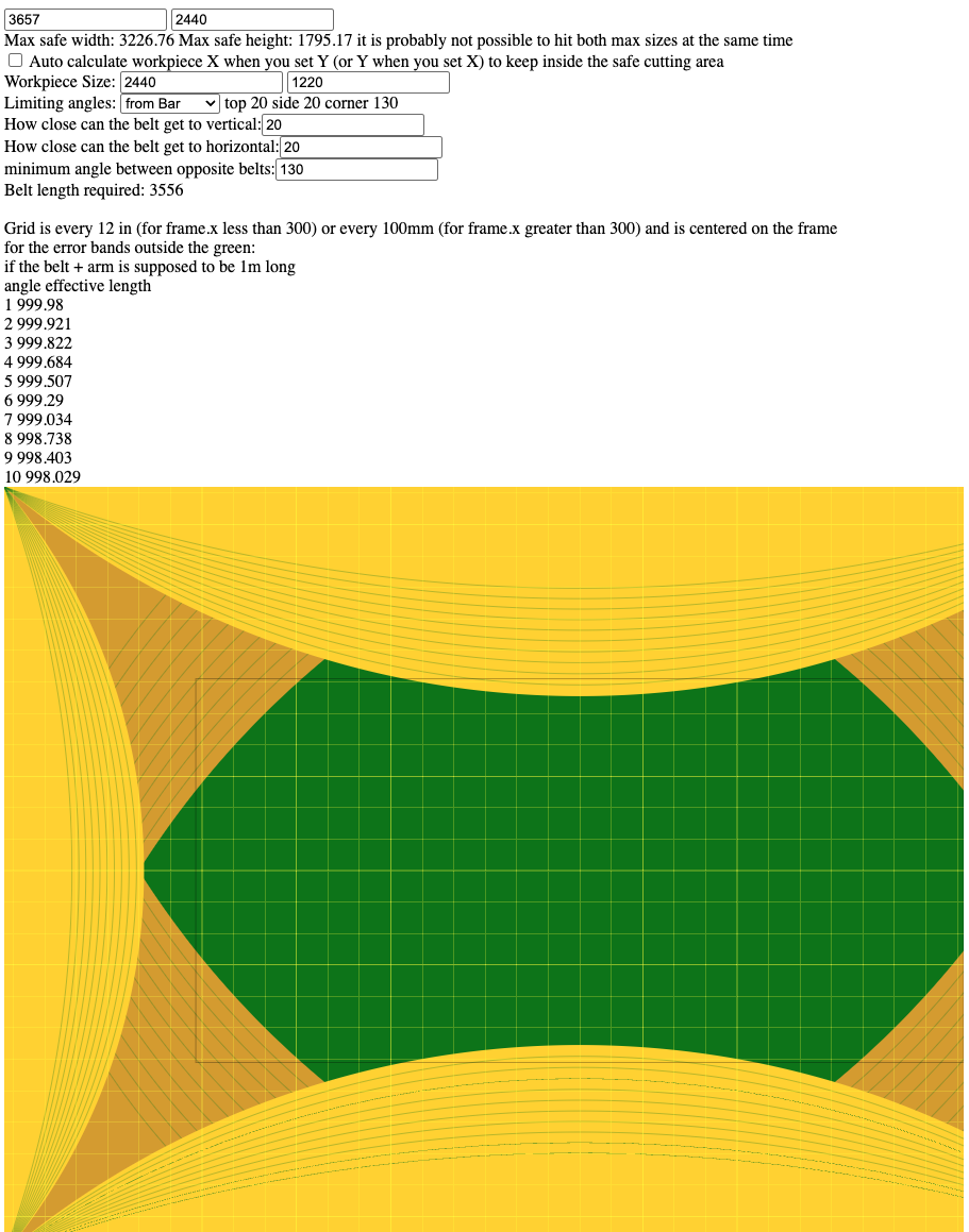

For example, kyleschoen just posted his frame dimensions in the screenshot of
the calculator. If you look at the calculator, you see that a line along the top
of the workpiece would start deep in the yellow corner, go into the green, then
into the yellow top, then the green, then deep into the yellow of the other
corner. If such a cut is made, how straight is it? how does any deviation of the
cut map into the different bands of yellow?
