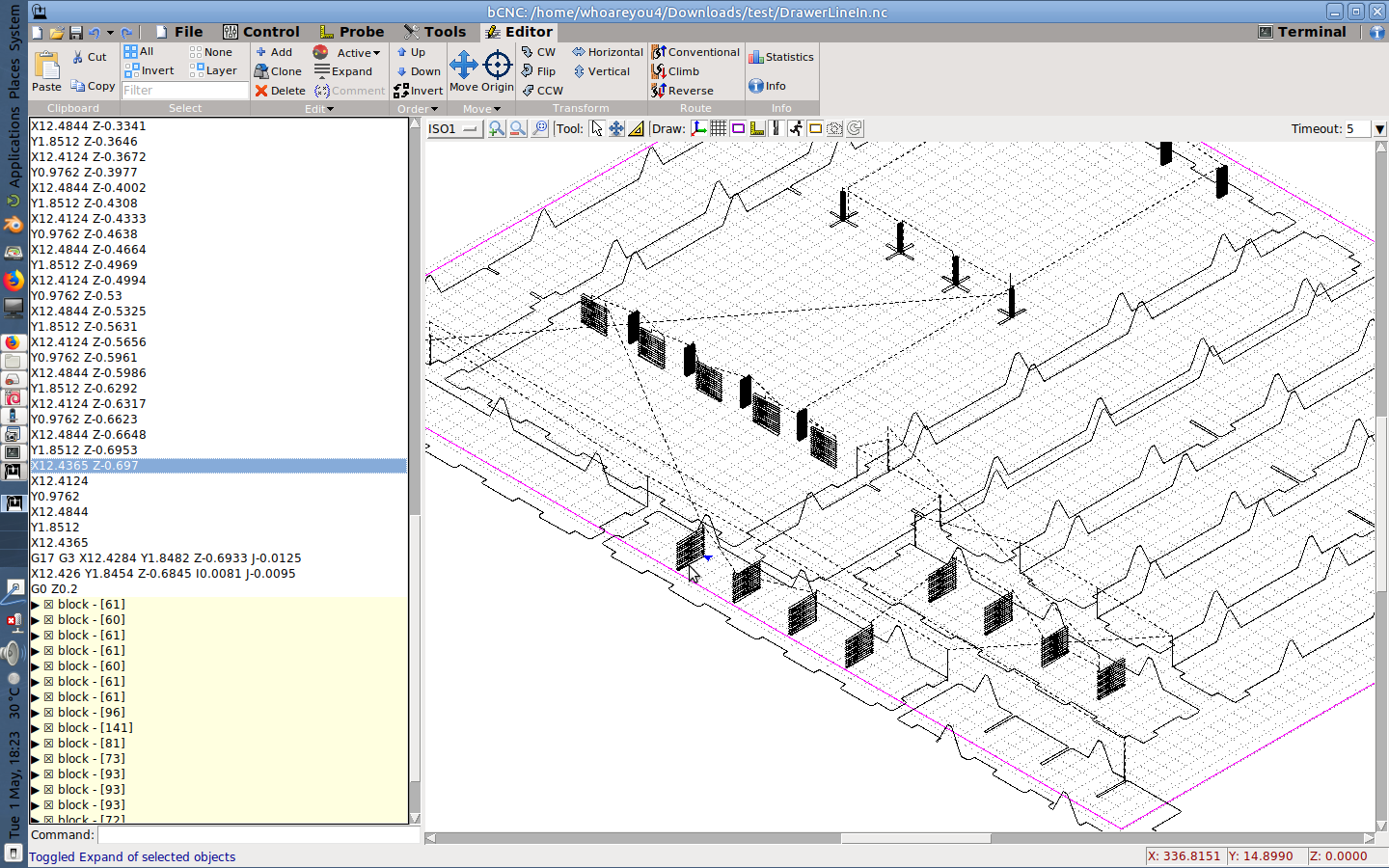

Created a simple silverware drawer liner to test my setup. Square corners, a couple of pockets, and straight lines.
DrawerLineIn.nc (82.4 KB)
When I try to cut, the bit goes to the first pocket, raises above the surface and then starts to plunge, but never goes below zero. X and Y move appropriately for the cut which seems to hover just above the surface the whole time. (Manually telling the Z axis to plunge from Ground Control works as expected.)
I thought maybe it was due to the file being set to imperial units. So, I regenerated in metric.
DrawerLiner.nc (81.7 KB)
Unfortunately, the same issue persisted. I’ve verified that both files have -Z offsets in the GCode so they should plunge into the surface. Per the suggestion here:
I tried adding a hard coded F command to line 20 (the first G3 command) even though there was an F in the G1 command on the line above.
So, have I missed something? Does Ground Control not support the flavor of G Code that I’m generating? Are the Z steps too small for the motor to execute?
The code has a mix of cuts in the sheet and parts that are above.

I installed bungies on my Z before my first cut as I had been lurking in the forums while waiting on my Maslow to arrive. When running the G Code, I can actually watch, after the Z is raised to .6 inches then dropped back to the surface, the Z motor doesn’t turn at all, even when the display in Ground Control indicates that it should G3 to Z of - .697 inches.
Perhaps something wrong with the connection? Several times I have started files where nothing happens because I forgot to plug the Z-motor in after doing a bit change or router maintenance. Perhaps there is a loose wire in the plug?
It looks like it wasn’t any issue with the hardware or cables. In the end, I ultimately managed to get the part to cut, but I had to switch to a straight plunge instead of a helical plunge.
The non-working G code used a lot of small arcs to descend:

The working version used just dropped the Z and then began moving:
G1 Z-0.2345
G1 X10.7082 Y14.1336 Z-0.2389
G1 X10.7095 Y14.1323 Z-0.2433
I’ll probably be setting up a test run at some point where I try generating a series of pockets using different plunge types to see if I can isolate and reproduce the issue. On the up side, I learned a lot more about using Fusion 360 to generate G Code in the process and I learned how to use CAMotics to perform sanity checks on the results.
Looks like helical plunge in Fusion might generically be an issue:
