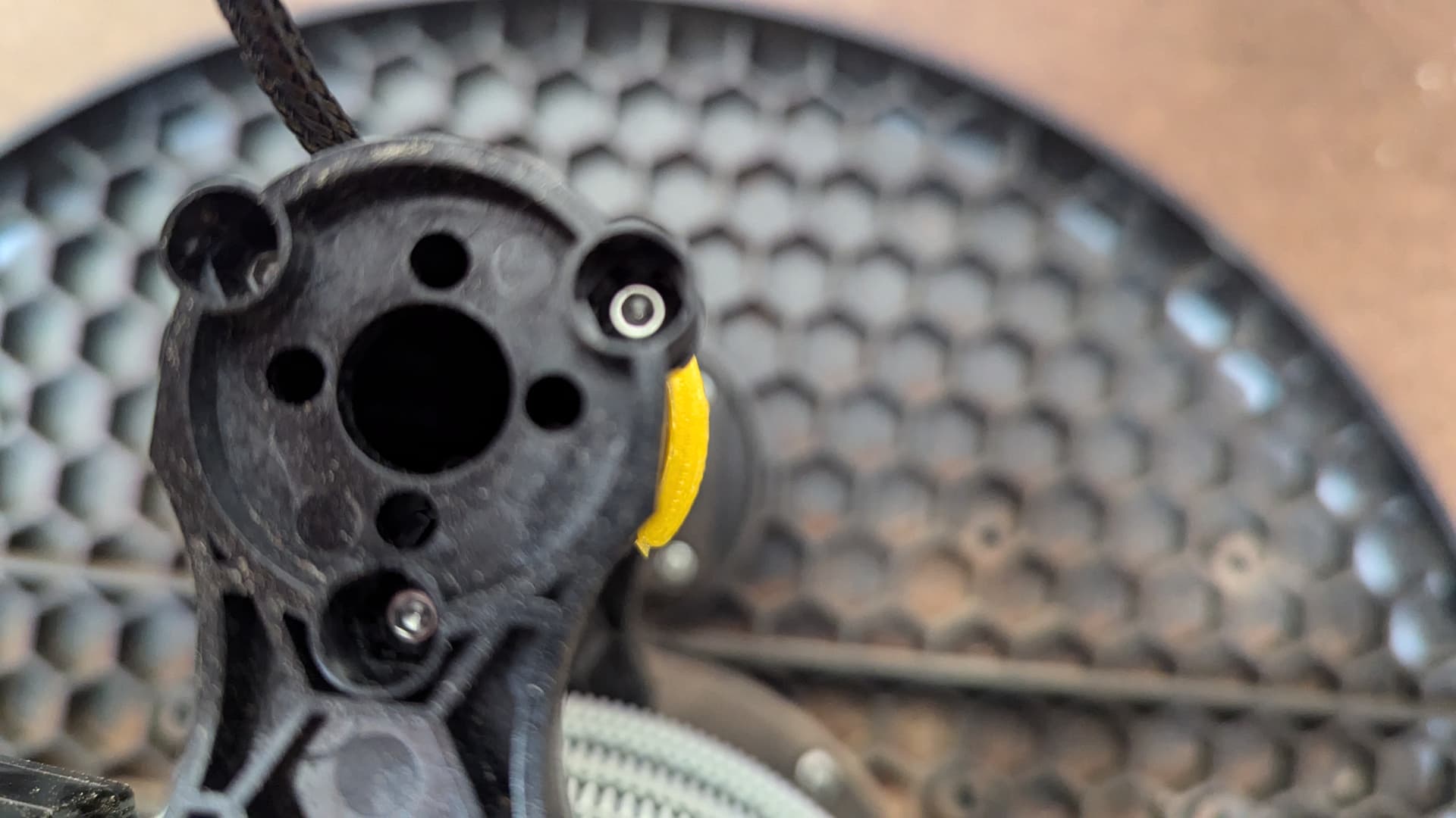

Hi,
In the online instructions it seemed to me the lead screw nuts would be attached in the bottom side of the uprights (the side nearest the collet) but in this pic from the same install guide later I see them on the top (yet still inside) the uprights closest to the control board end of the router.
I moved mine to the location in this photo from the site.
Is this correct? Where do they belong?
Thanks all.
-Jeff
given the standard screw lengths, having the heads below the nuts will give you
a few mm more Z travel. If you get/make some shorter screws so that they don’t
go below the leadscrew nuts, you would gain a few mm mnore by putting the nuts
below the arms.
