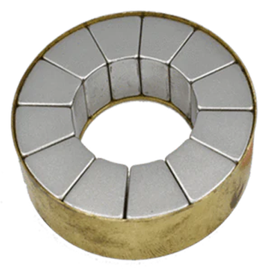

I have my 4.0 scattered all over the table in the laundry room, and somewhere in the tear down I have lost a roller. Yes, I have already have on hand a bag of replacement rollers. BUT, yes, the one with the magnet is the one gone away. Looked everywhere I can think, and my wife joined me. No joy. I have ordered replacement magnets but they are shipping from China, don’t know when the will arrive.

you are looking for an radial polorized magnet, I think 3mm diameter, but am not
sure
‘standard’ magnets have the poles on the flat sides (top and bottom), these
magnets have the poles across, so N and S poles are on the curved edge

Unfortunately they are pretty custom made. AMS (the manufacturer of the encoder chip) used to have a really generous program where they would send out free samples, but their website has changed a lot.

Since (at least to me) the significance of the type of magnet was not known, I wonder if anyone has created their own problem by subbing a plain magnet? I can visualize how the rotating poles would be needed for a proper measurement of rotation, a regular magnet would not do anything for the sensor. I hope no one battled that!
