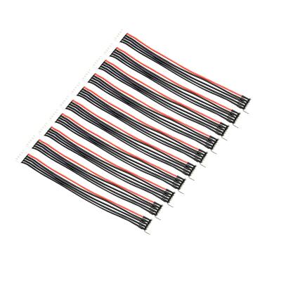

1s (2 wire) for the motors, 4s (5 wire) for the encoders.
extension cables are available pretty cheap
from china, this link has a high shipping cost, but if you spend time hunting,
you can find other options.
https://www.aliexpress.us/item/3256808165496915.html

The ethernet connectors proved not reliable enough which is why we made the switch to JST connectors in 4.1 so maybe it’s a contacts issue? That’s what the LEDs looking erratic seems like to me.
