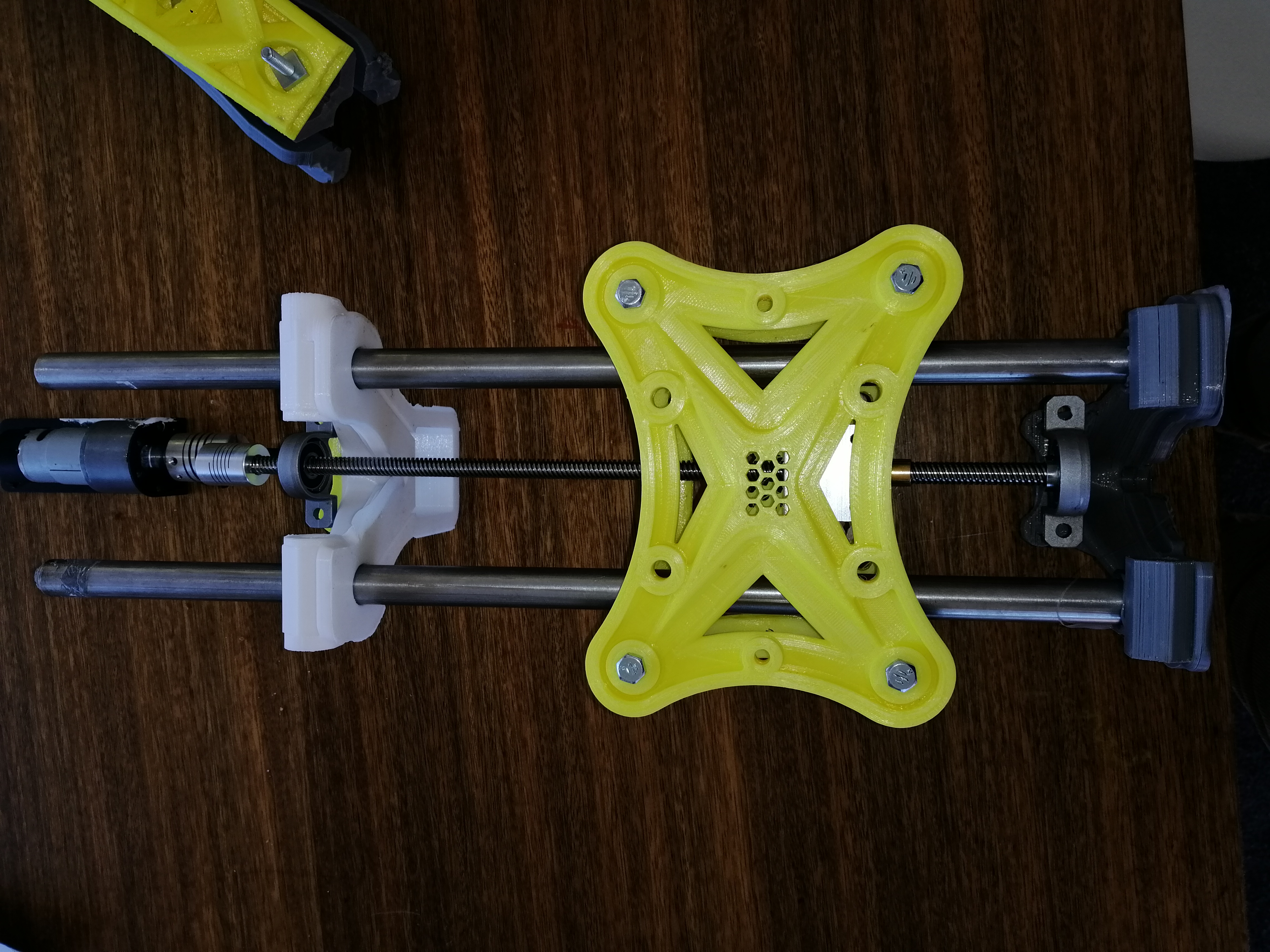

Maslow 3D V2.0 3d gantry type
Im am currently building a 3d maslow that uses a lot of 3D printed parts. I got the idea from the maslow mark 2. I was also tossing around the idea of losing the gantry and mounting the router on a telescopic gantry.

I am going to mount it vertically 90°, so that it doesn’t take up to much space. A lot of the ideas I got came from MPCNC. The pictures show a only the top rail but the is also a bottom rail. The main reason I am building this is so that I can mill 3d profiles. I also plan to mount a plasma cutter that will be operated with a limit switch.
the first picture is not working for me

In my figuring the gantry has no way to stay square especially along that length. I’d think if you were anywhere other than the middle and applied a lateral load the two vertical guide rods would go out of square with the horizontal and possibly not even stay parallel to each other.
I think you need a piece that fixes each end of the vertical much like the brackets you have for the router (something rigid with diagonals. In my estimation that’d keep the ends square and let the whole gantry move as a single cohesive unit.
But again this is just my thinking, you’re the one actually doing!
