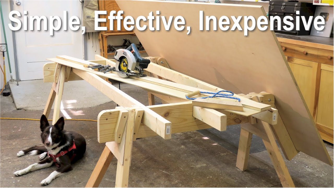

For another option, I just came across this video for a breakdown grid for working with plywood, including loading arms. I’m guessing it could be modified to work for the Maslow.
Here’s a link to his plans: Handling and Cutting Plywood Plan – Workshop Companion
That dude rocks. I’m going to have to check out some more of his videos.
