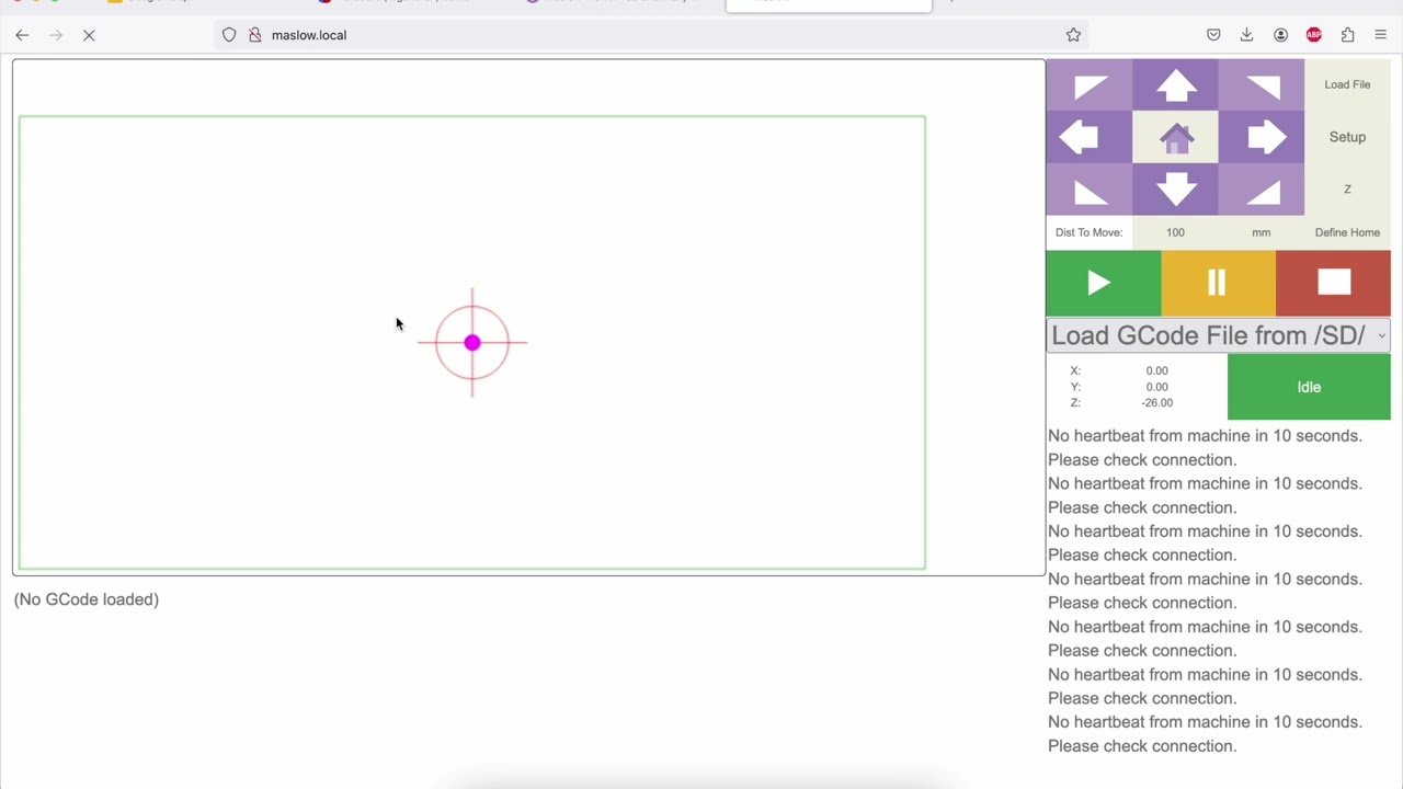

Start calibration (90 points)> console list points > machine moves to all points and operates belts > console never updates with waypoints > process appears frozen on console with nothing recorded > after 10 min console says

0.65 adds a feature where if it gets disconnected, it will finish the computation when you reconnect so if you get to the situation where the calibration is finished and nothing has showed up in the console, you could try closing and reopen the browser. It might automatically start the calibration process once you do.
I need to do more testing today with what happens if the Wi-Fi connection goes down during the calibration process. It should be robust to the computer turning off, but I don’t know about the Wi-Fi network.
This has been added in the nightly release 0.65.1 and will be part of the full Wednesday release.
I did some testing with it and I’m excited to share that if the wifi connection goes down the machine will automatically reconnect, you just need to refresh the browser window to re-establish the connection from the browser.

The good news is that the calibration process seems to recover well from a loss of WiFi connection in the middle of the calibration process (which I think is what you were running into). I made a quick video to show how I was able to get it to recover:

I didn’t realize there was an option to reload the page without killing the whole thing.
It had been doing exactly what you described- moving though the points and stopping on the last with no further activity.
