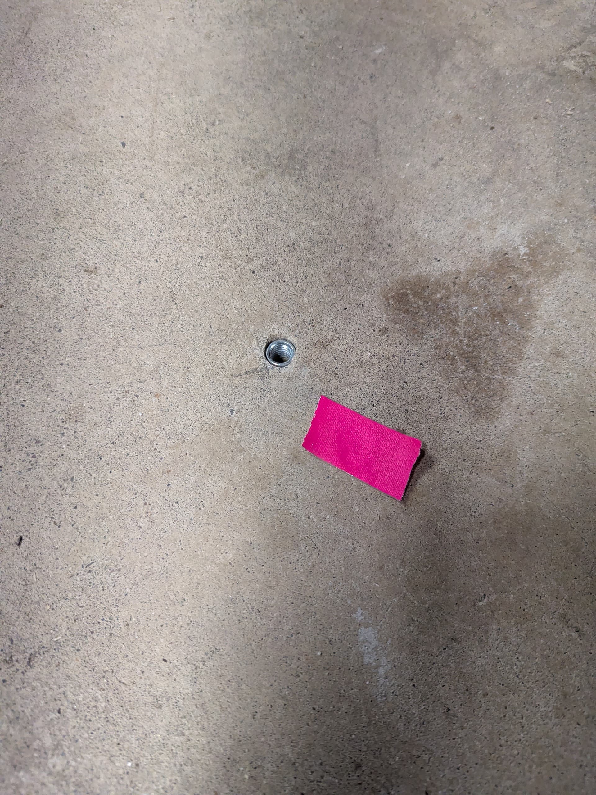

Ok here’s my beautiful frame. (Sorry I had to)
Took all of an hour and a half to lay out with a laser level.
With the studs in it is 0.5 inch out of square which I think I can live with.
I will probably grind the top of the threaded rod down so that I can seat it a little better with a wrench but even just by hand there’s little to no play. Now I’m thinking about maybe a delrin bushing to go over the threaded rod and in between the eyelet of the belt - might make rotation a little easier.
