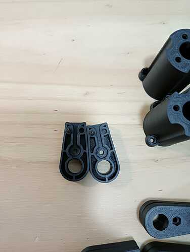

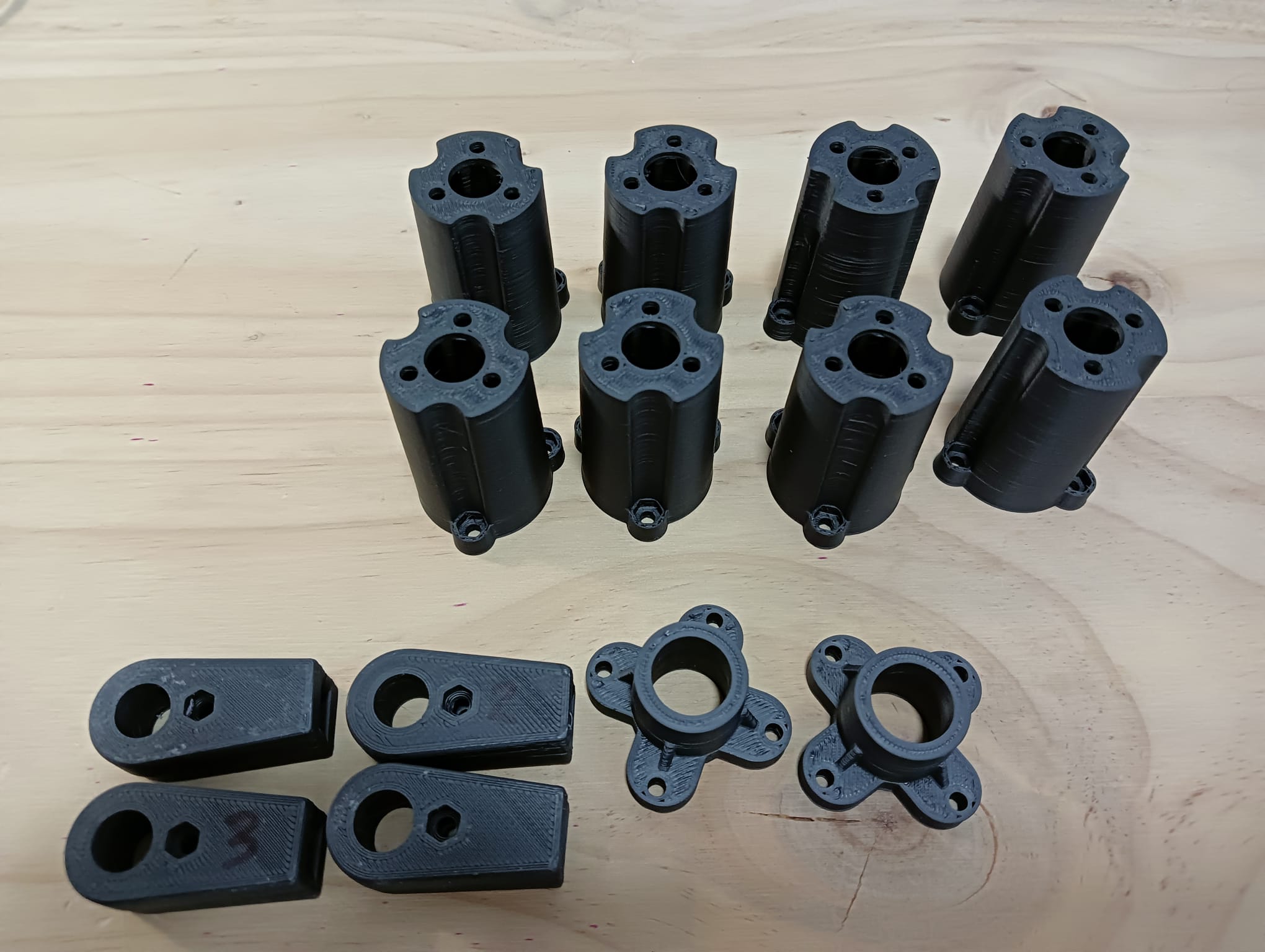

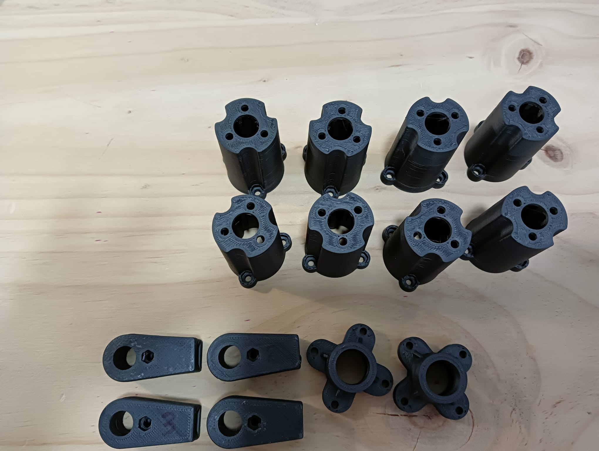

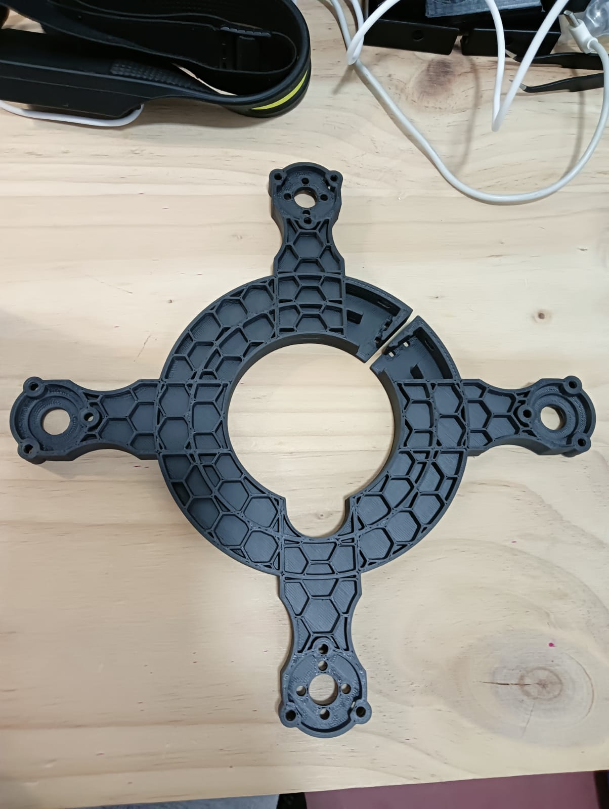

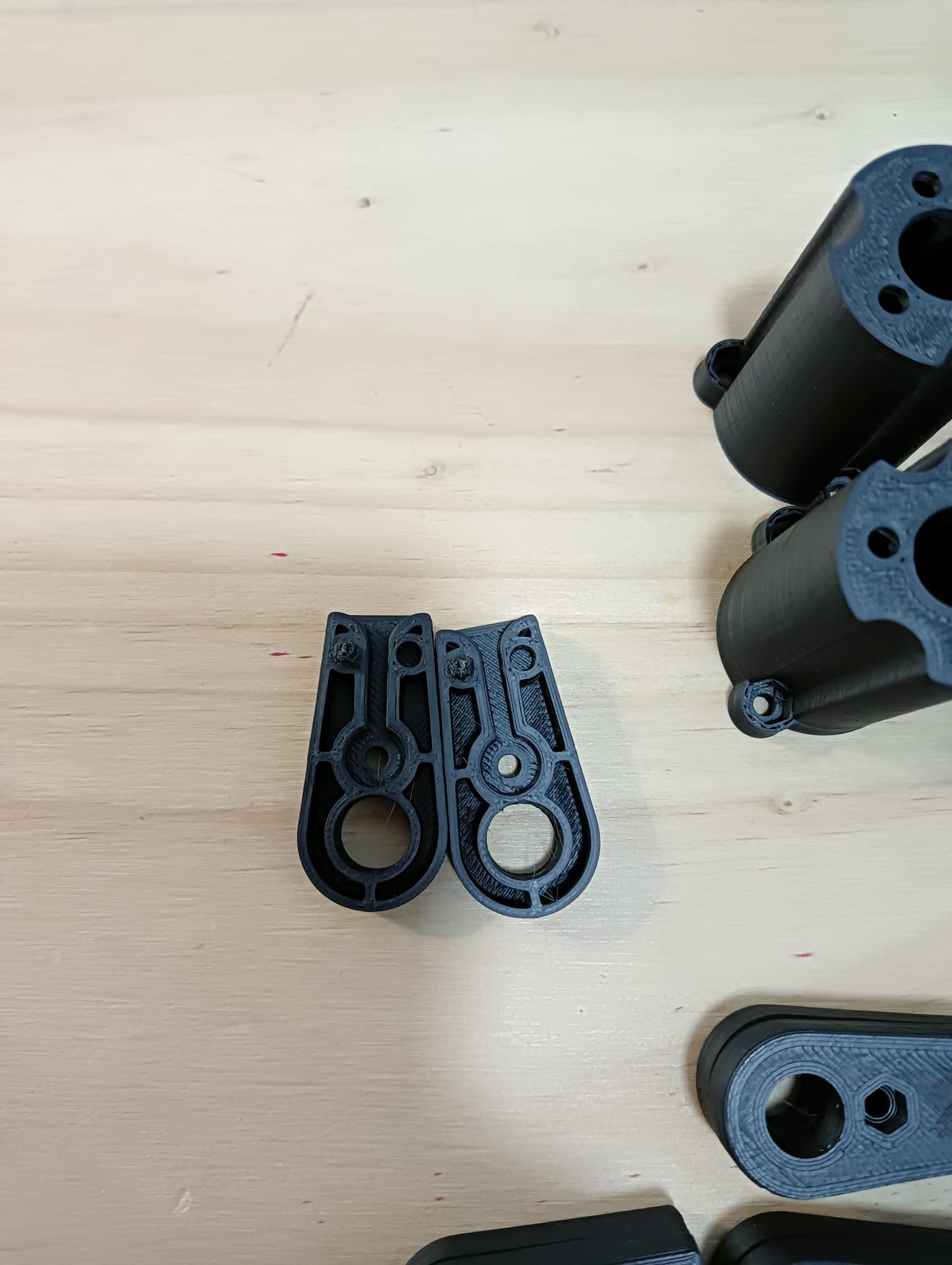

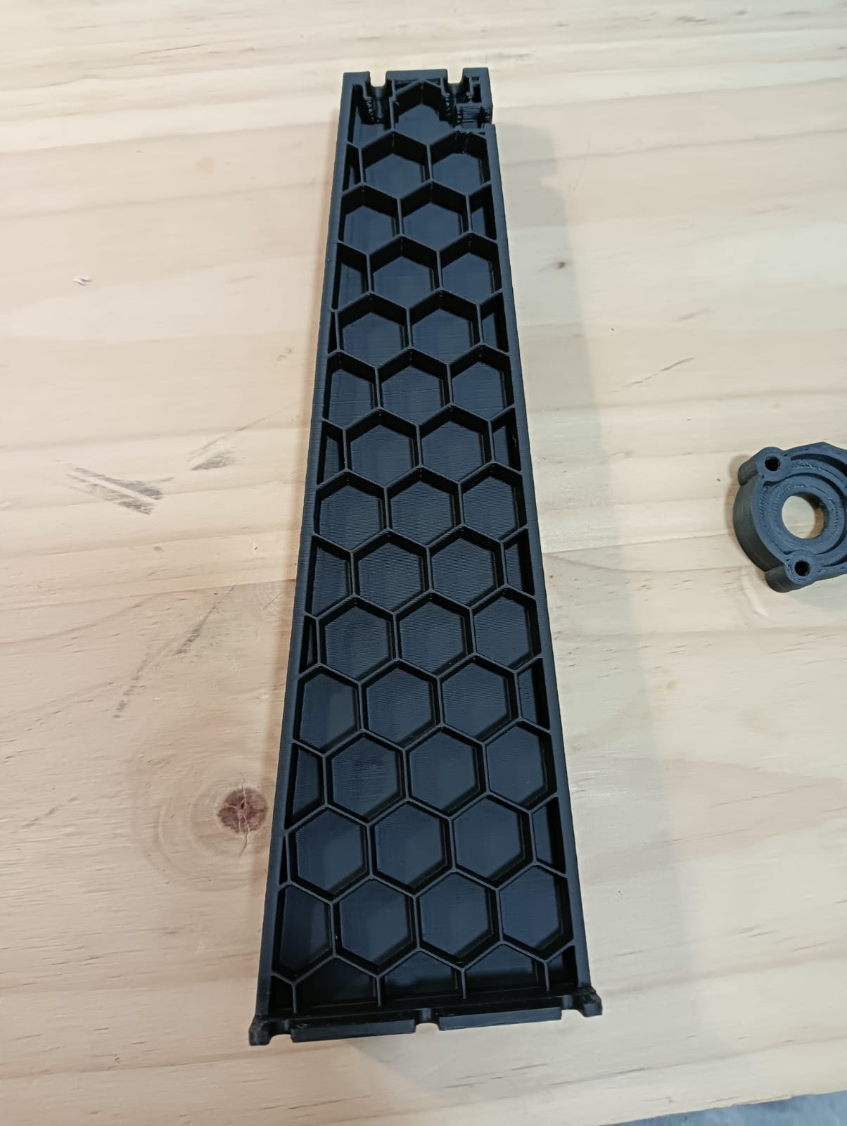

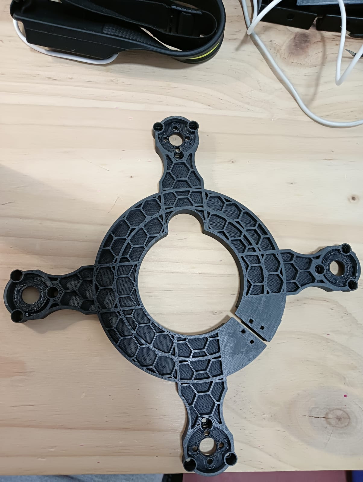

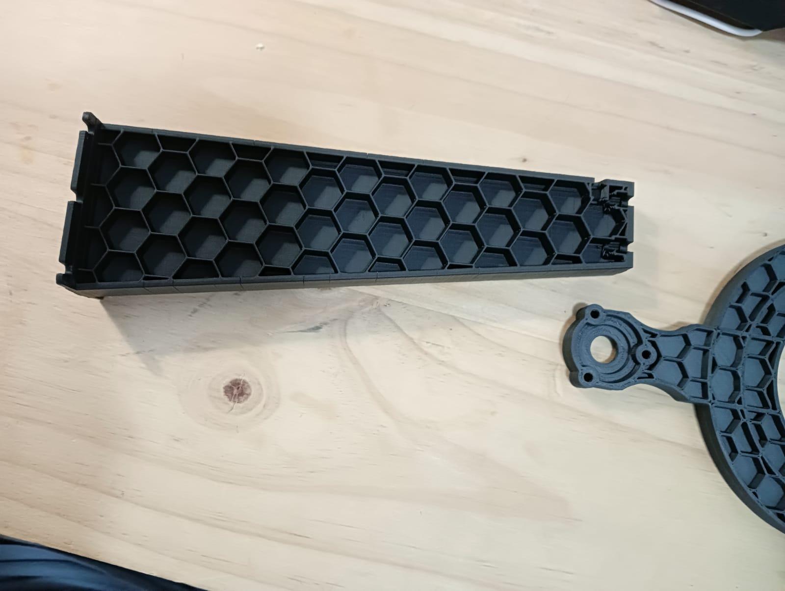

Hi, finally I m starting to print some parts no critical in ASA (Winkle brand from spain) 25-50%filled.
temperature 245/ 80 bed, 15% fan
Photos attached.
Those are looking great!
What about Carbon Fiber reinforced Nylon? Not every printer can print that though (the Prusa should definitely be able to)
More printed parts,
