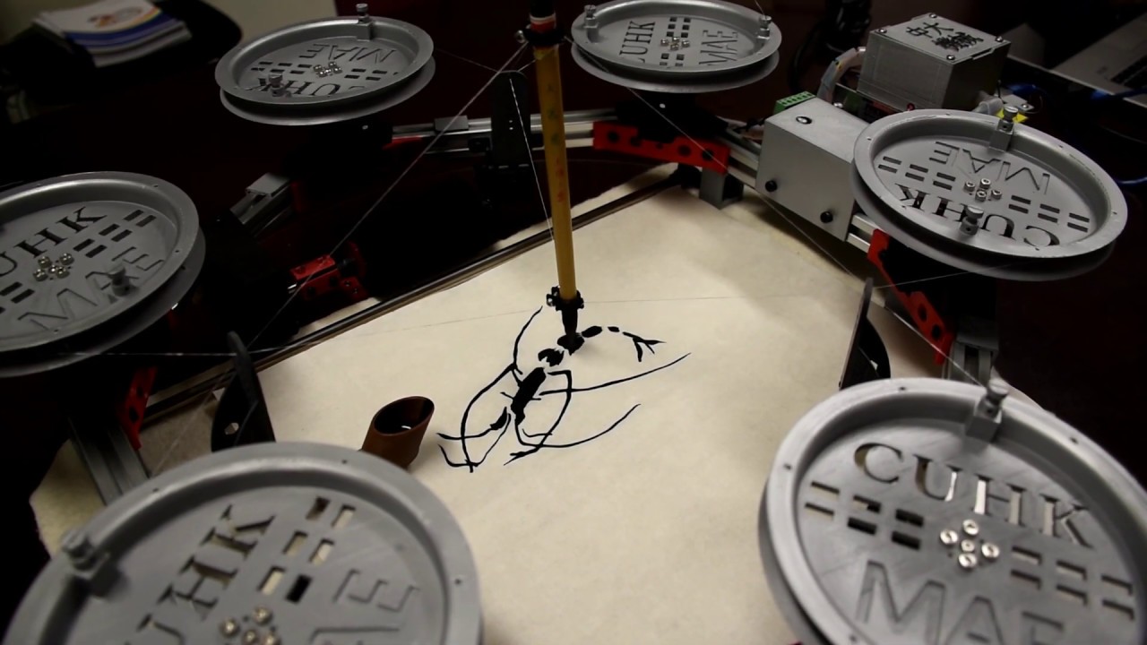

I think that this has been posted before, but I just came across it again
I wonder how they are doing motion planning? It’s an amazing project
Edit:
Here is a description of how the paths are generated (narrated by Obama!):
