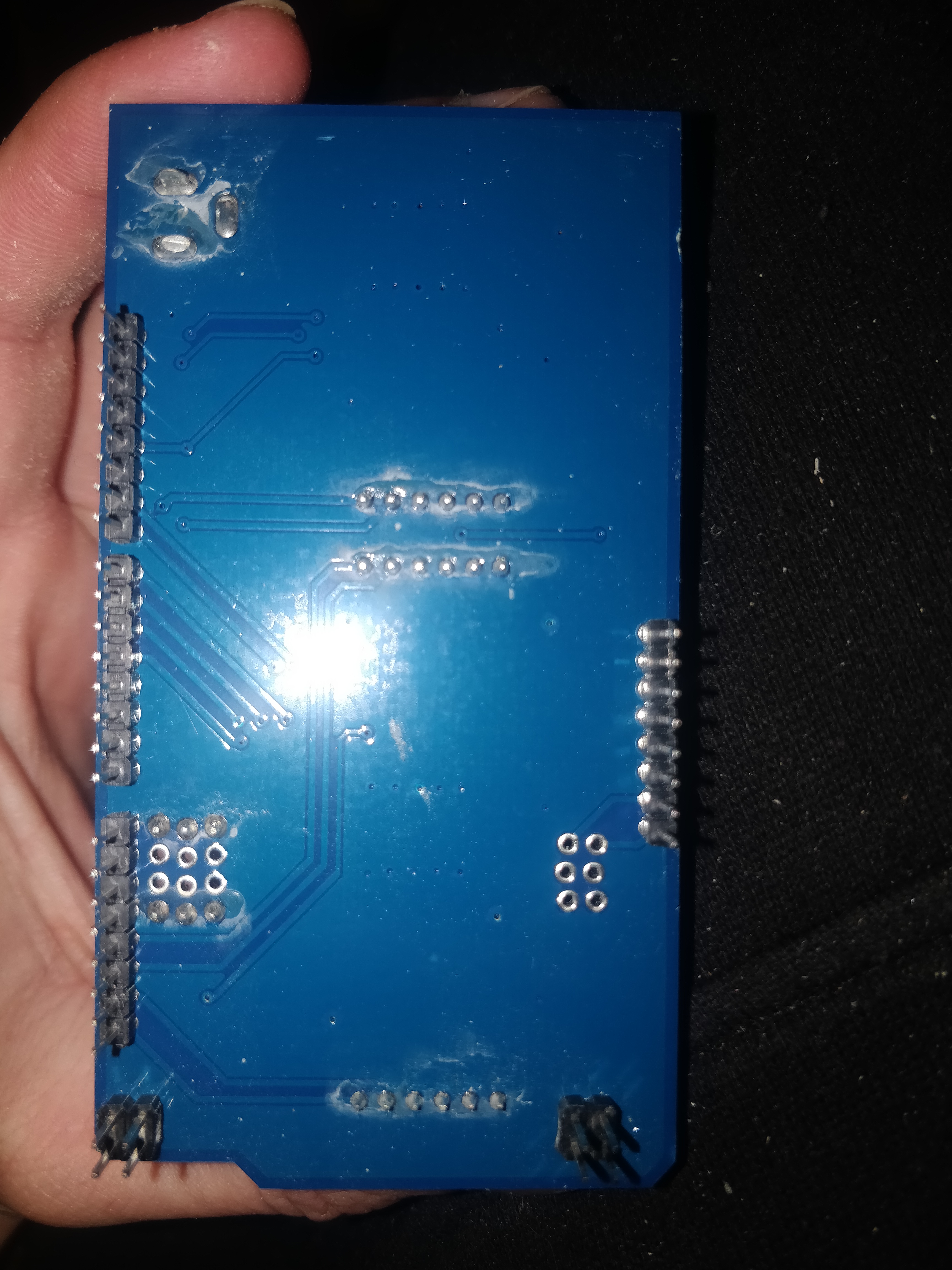

It’s possible the motor controller shield is damaged. The encoders, however, are basically wired straight through to the arduino so you should see encoder movement if you can move it by hand. Can you post a couple of good pictures of the motor controller shield (top and bottom… you’ll have to remove it from the arduino to get a bottom picture).
Here are the photos of the motor controller shield. It seems that the shield heated up until it was damaged.
I don’t readily see anything fried… and since the heatsinks are still there, I assume the chips under them are still there (there’s a failure mode where the chips fall off the board).
I assume you have a multimeter since you checked out the cables. Can you hook everything back up and make sure you get +5V and continuity to ground on the three connectors on the motor controller… follow this schematic (the part in the top right):
