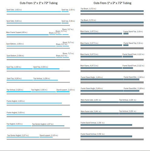

Hello all,
First post on here. I’ve been digging around on the forums for a few weeks now trying to read about people’s frame designs, improvements, and adjustments made. Below is the simple sketch of my proposed frame design, made from 1"x1" square tube stock and 1"x2" rectangular tube stock. I plan to weld the main frame and two supports separately, and then bolt them together. My goals were to:
  1. Have an additional width on the top bar of 12’ overall, and increase the distance above the work piece to help with chain tension issues
  2. Remove any possibility for flexing of the top motor bar
  3. Design an 8" skirt around the work piece to allow for the best possible edge performance.
I was hoping to get some feedback to see if there’s anything else folks on here might suggest or modify over this current design. I’ve heard some talk that going 14’ wide is even better, but I start running into space limitations in my work space going that large. It seems like I’ll need about a 15’ long chain on each side to allow the chain to be properly tension on the non-working side. Thanks for looking and any input is much appreciated!
@mhnudi Welcome to the forum! Very nice design and kudos for sharing it and looking for feedback. A top bar that is 12’ wide and 30” above work surface is looking to be optimal. @dlang has a spreadsheet that you can use to calculate forces with different frame dimensions.
To completely eliminate flex in the top bar you might want to add another support at each end of the top bar. However, square tube is very strong and the ~30” on each end may be short enough that another support isn’t necessary.
What angle are you using?
Have you thought about how you will fasten the spoil board to the frame and how the work piece will rest on the spoil board?
Looking forward to seeing what you end up with.
@WoodCutter4 thanks for the response! Thanks for mentioning the spreadsheet. I somehow had missed that so I’ll need to take a look and pass some numbers through. This current design only has the top bar at 24" above the top edge of the material, so I may play with those numbers a bit and see if closer to 30" as you mentioned would be better (and if it’ll fit nicely in my garage!).
At this point I’m not sure how much flex the bar would have using 1/8" thick tube vs the more common 1/16". I think your suggestion is great though and it would be marginally more work just to add some angled support bars which I added to the mockup below.
The angle I was planning on is 15 degrees, which I think is in alignment with the stock frame. I’ve seen people use other angles like 10 or 12 degrees, so I’m definitely open to suggestions or comments on if 15 is the right choice.
As far as the spoil board, the plan is to mount it to the internal “frame” within the frame design. The inside rectangle is 4’x8’ at the edges, which should allow me to drill 3-4 holes per edge to mount the backer board. Then, for the 8" wide perimeter around the 4’x8’ inner frame, that will get two layers of material. The first layer matching the thickness of the spoil board, and then the second layer matching the cutting material thickness. Ideally this second board should not really need changed often if the material thickness you cut doesn’t change often. The plan again here is to drill some holes in the square tube to allow it to mount. Then the top layer can just be screwed into the first layer. That was my plan at least to keep the cutting material secured and to provide clearance over the edge for the sled to ride on.
I attached a revision to the original drawing to include the angle annotation, then the change from 24" to 30" for the top bar to the work area, and the angled supports. Thanks for the feedback!

you would gain more stiffness by putting a angle iron or second tube along the
top beam (making it taller) than by going to thicker walls
Agreed, I just will be using 1/8" wall thickness metal because it’s what is readily available (and cheaper for me) for this build. I agree welding the second tube like you mentioned would be best for deflection. I’ll probably start with the single and then it can always be modified later. I just figured after seeing people use a single piece of unistrut for the top beam that a 2" x 1" x 1/8" beam would be strong enough.

You might be surprised. A single strut, without sufficient supports will twist and flex quite a bit since it is “u” shaped. Anything will deflect, just a question of where and how much.
One thing to think about is; you will probably fasten the motor brackets to the top of the tube and you will need to be able to fasten pulleys or bearings along the top bar for chain slack management. If you start with one tube and then later you want to add a second, it would probably be easier to add it under the first (raise up the original, if it isn’t welded) but it would require recalibration since the motor height would be different. Easier yet would be to just start with two, especially if costs aren’t much of an issue and you have the goal to eliminate flex. :slight_smile:
you do not need 18in of clearance on the bottom. 12" should work if you do not use bricks (lead is best) . I have to stand on a step; stool to reach the top of the motors I think 1x2 tube with 1/8" mild steel walls is more than enough, I would not worry about any flex especially with those triangle supports.
it is good you have it in 2 sections because if you ever want to move it out the garage, you will probablay need to disassemble it anyways.
if you just want to bolt it together instead of welding you can use tube connector nuts

Figured I would post back after making modifications, including a breakdown of my cuts. All cuts planned are from 72" stock since that is what I have available. I’ll probably transition this thread into a build log as I make progress. This frame is going to be super overkill, but I think it’ll be a fun project.

looks good. 230 lbs does seem like overkill. I have not weighed my aluminum frame but I would guess about 45 lbs. I’m guessing 1/8" thick steel tube is the main reason for the 230 lb weight. If I made it out of steel I would of used 1/16 wall tube, or even 18 gauge tube, but 18 gauge tube is much harder to find.
I guess if you never move it, it’s fine. but if you do plan to move it thinner tube wall will save you $$$ and IMHO not have any drawbacks.
