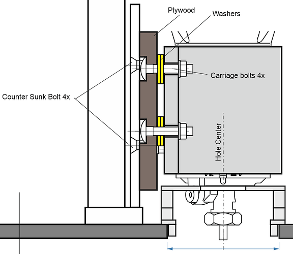

While we could of make a bunch of z axis holes for different sized routers, we decided it was easier to use spacers to make the center of the router match up with the center of rotation. Ridgid and Makita Router clamps match up automatically. The dewalt clamp requires spacers be added.

It is a bit of a puzzle to get the router in the center of the hole. I made a drawing to figure it out. I solved the distance with a piece of plywood which I bolted to the z axis sled with 4 countersunk bolts. Then a used 4 carriage bolts and 2 washers for each bolt to get the clamp in the center. I used carriage bolts because they don’t slip and I was able to line up the clamp on the sled from the outside without having to disassemble the z axis everytime I had to adjust.
