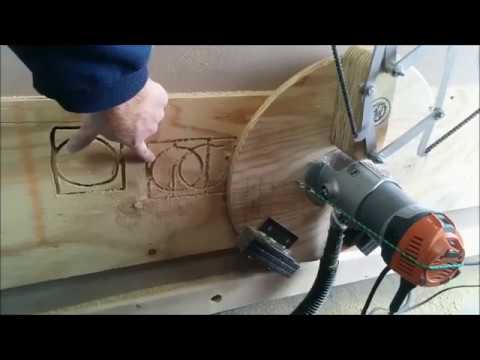

So unfortunately I didn’t get very good results. I think I know why and I believe I can fix much of my issues. I’ll let the video do the talking:
My takeaway from this is that I need to add weight to the sled. I have not weighed my sled yet but even by my calculations its at 21lbs, which is the same as the stock sled with only 1 brick. I made my weight system so I can easily add weight, I just need to make a few more bars. I am fairly confident that will take a lot of slop out of the chains. I may also modify my riser setup so that the linkage nuts don’t bind at the lowest corners of the bed.
Right now I have >0.5mm tolerance in the center 2’x2’ of the bed. Out to 4’ left to right its closer to >1mm. The top and out to 6’ is somewhere around 2mm, and beyond that its useless. You can actually see in the farthest out tests that the cut “drifts” towards the slack chain, making me think this is an issue with weight. So I have about a 3’x4’ area in the center of the bed where my cuts are acceptable. For my current projects, that is okay, but I will be improving this. I would like to get 4’x6’ if that’s possible. I also haven’t tried to cut too close to the fence, as it’s a 2x4 and it sits proud of a 3/4" sheet of plywood. I need to make a plywood fence to fix that.
Loosing 8" of motor spacing isn’t helping either. I really wish I had more space for the machine, I would extend the motors as far out as possible to get better results across the entire bed.
As usual, the to-do list grows. At least I enjoy doing the work :smiley:
that does look like too little tension on the chain, so adding weight should
help (tilting to closer to vertical may help as well)
I didn’t quite get the question you were asking as you rotated the sled.
"i would extend the motors as far out as possible to get better results across the entire bed. " Wouldn’t that increase the chain sag near the edges as the chain would have to be longer? The best option for optimal results seems to be repositioning the work piece near the center
It would mean that there is more chain on the slack side, which would increase
sag, but it also means that the chain on the other side is not as close to
vertical, which means that more of the weight of the sled is available available
to apply force to the slack side and that makes FAR more of a difference than
the added length.

Got some more tests done last weekend.
I added 20lbs worth of steel weights to the sled. I can now get a good triceps workout every time I attach the sled :wink:
The added weight has helped immensly.
I sacrificed a sheet of CDX to a rigorous tolerance test to see where distortion was the worst:
I numbered each of the squares and listed their tolerances below:
My conclusions:
I need to work on the accuracy at the top of the bed. The chain actually jumped on me during testing and I’ve been revisiting my risers a little. Apparently I had quite a pitch to my chains, and never noticed because I was never in the top left corner of the machine. The squares on this particular test were too high up and the sled also tilted (after it jumped a chain link). I decided to abort the top row and investigate the results I got on the bottom half.
I’m actually pretty okay with the results I saw across the bed. I still haven’t gotten the X-Y calibration right with the linkages, so I’m out somewhere about 1mm consistently, with the X being longer than the Y. On the far right and left squares at 1m out, I expected that I would start seeing distortion on X-Y because of my motor spacing. I can see some of that distortion creeping into the 750mm and even some of the 500mm squares, which really limits me to about 600mm (~12") off center for good accuracy. The Square tolerances reflect that distortion that is happening.

looks good. I think things will improve significantly once you get the
calibration dialed in.
Please keep posting details.
