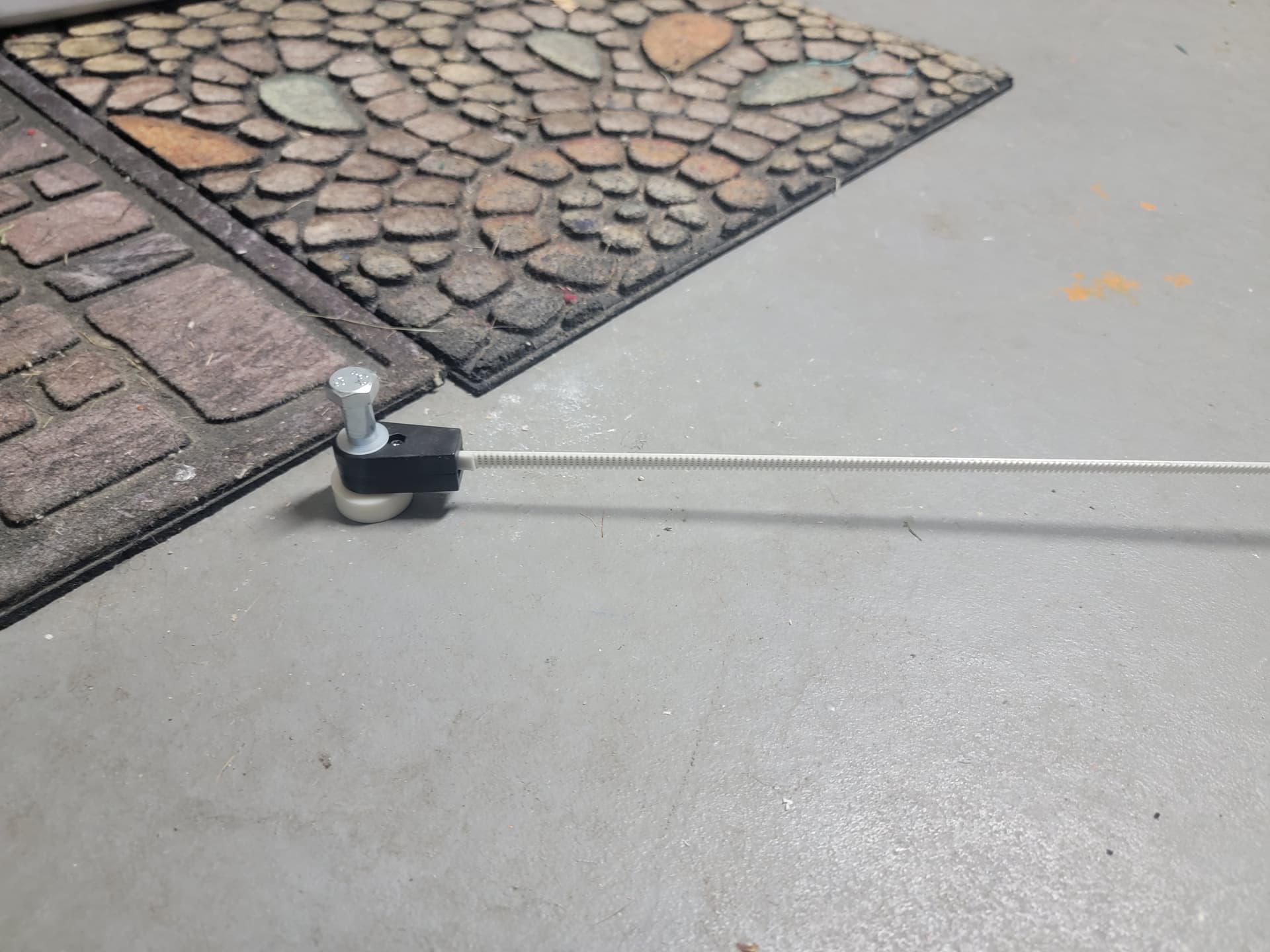

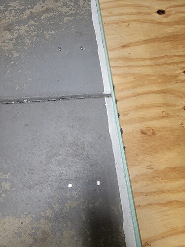

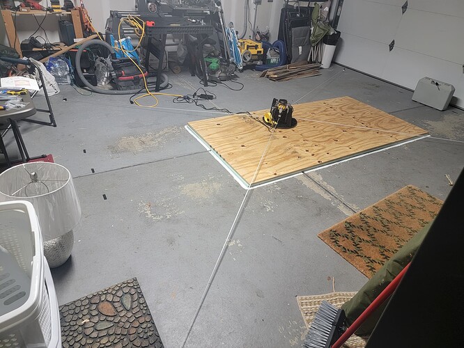

I just did this yesterday. Calibration running this morning, so I can’t yet speak to the results. I put a drop in anchor at each of the four mounting points and some around the perimeter of my work area to give work holding options. In the mounting points I am using a nylon spacer below the belt end and a nylon washer above.
I am dying to hear how THIS works because this was our EXACT idea. If you would share which anchors you used, I’d love to recreate that setup
I used red head drop in anchors threaded for 3/8. My calibration is still running, but slowly working to higher fitness score. I suspect that I need to get the belt ends higher than they are, so am printing some thicker spacers today.

Calibration completed overnight (I had to re-start because I realized that I had a twist in one of my belts) and it was able to get to .77. I did take the opportunity provided by needing to restart the calibration to put the thicker spacers in that I had printed out.
I’m going to do a little bit more digging to make sure that I fully understand operating procedures and then will be trying my first cut. Likely I will be doing some dry runs without the end mill.
