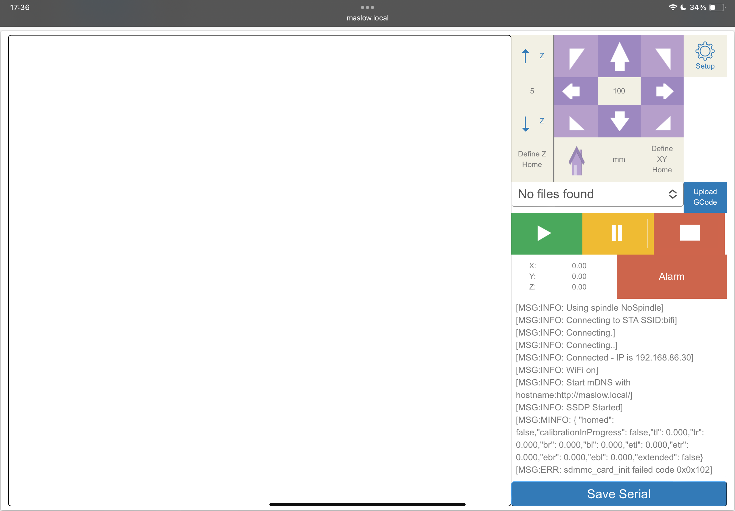

[MSG:ERR: sdmmc_card_init failed code 0x0x102]
I have downloaded and installed the 0.82 firmware, the index file and the maslow.yaml file. I am attempting initial calibration on a floor-mounted setup. I got the belts to retract, mounted them to the anchors, and in spite of putting what should be the right machine dimensions corresponding to 12’x8’, the machine pulled itself toward the bottom right corner right off my 8’x4’ platform that’s centered between the anchor points. I proceeded to extend all belts so it could be placed back in the middle of the platform and two belts wouldn’t extend with the dedicated button, but only using “Release Tension” over and over again. Once all were fully out I was getting an error that suggested calibration cannot happen without all belts being fully extended even when they were. I can see the spools (to confirm they’re all the way out) besides the long belts sitting on the ground.
The other - and potentially related - issue that had been intermittent, but is now constant in spite of attempts to restart FluidNC and to power cycle the machine is the one in my title line. I get an error that reads [MSG:ERR: sdmmc_card_init failed code 0x0x102].
Please advise.

What is the meaning of the sdmmc_card_init failed error code? Since we aren’t discussing it, is it to be considered harmless, or can it be at the root of my issues?
I have seen this error many times, and for me it has always resolved after a power cycle or two of the m4. It comes from the firmware not being able to initialize the configured sd card (really not a “card” in this case, as its hard-wired on the board).

The normal reason that this happens is that the maslow.yaml file tells the machine which pins to use to connect to the SD card. If the machine powers up and doesn’t read the maslow.yaml file correctly it won’t find the SD card and you will see that error message.
The quickest thing to try is just to delete the maslow.yaml file and replace it. If that doesn’t fix the issue we can send you a new controller board so we can be sure that the issue isn’t hardware related.

Sorry for the slow response. Work has kept me very busy. It is still happening. I have deleted and attempted to replace the yaml file several times. Once or twice when I had first powered up the unit after completing the build it connected but now it won’t regardless of what I do. I hope it turns out to be a simple hardware fix since it’s frustrating behavior.
It’s possible that it’s a hardware thing then since the SD Flash chip is on the driver board. Let’ me DM you a code for a replacement board.
