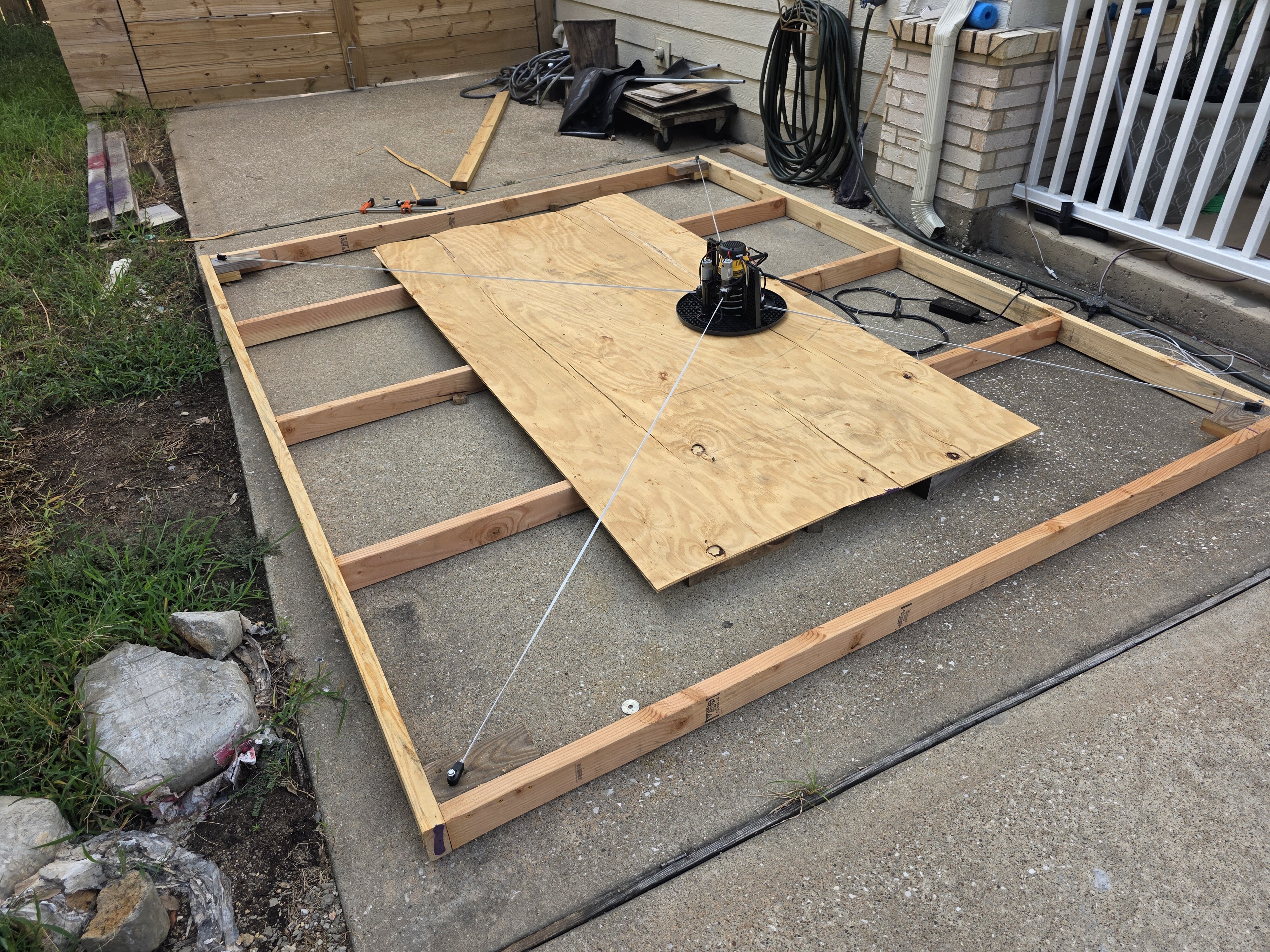

My Maslow 4.1 it keeps getting stuck Midway in a calibration and says on the computer to restart and computing Rob and waiting it doesn't do anything after a few markers and went through like six movements and stop every time can't finish

The cnc she’s getting stuck on the same spot doing the same thing nothing kind of rides like three movements and then it just stops and doesn’t want to work anymore what do I do I want to use my machine please

I think posting the log from this run and seeing if there are still any funky readings would be the next step.
Hi James,
I am in Australia so a bit hard to communicate directly. Can you put a copy of your Maslow.yaml file and the latest log file up.
Please check the following:
The maslow is set to horizontal
Can your belt ends pivot easily on the anchor? must be able to pivot.
can you measure the distance between anchor points TL to TR, BL to TL, BR to TR and the diagonals BL to TR and BR to TL where B is the side the power comes out of the maslow
(TL Top Left)
So I put that file the most recent one in the yellow folder app thing on the top
Need to post them here (latest Log file & maslow.yaml)
