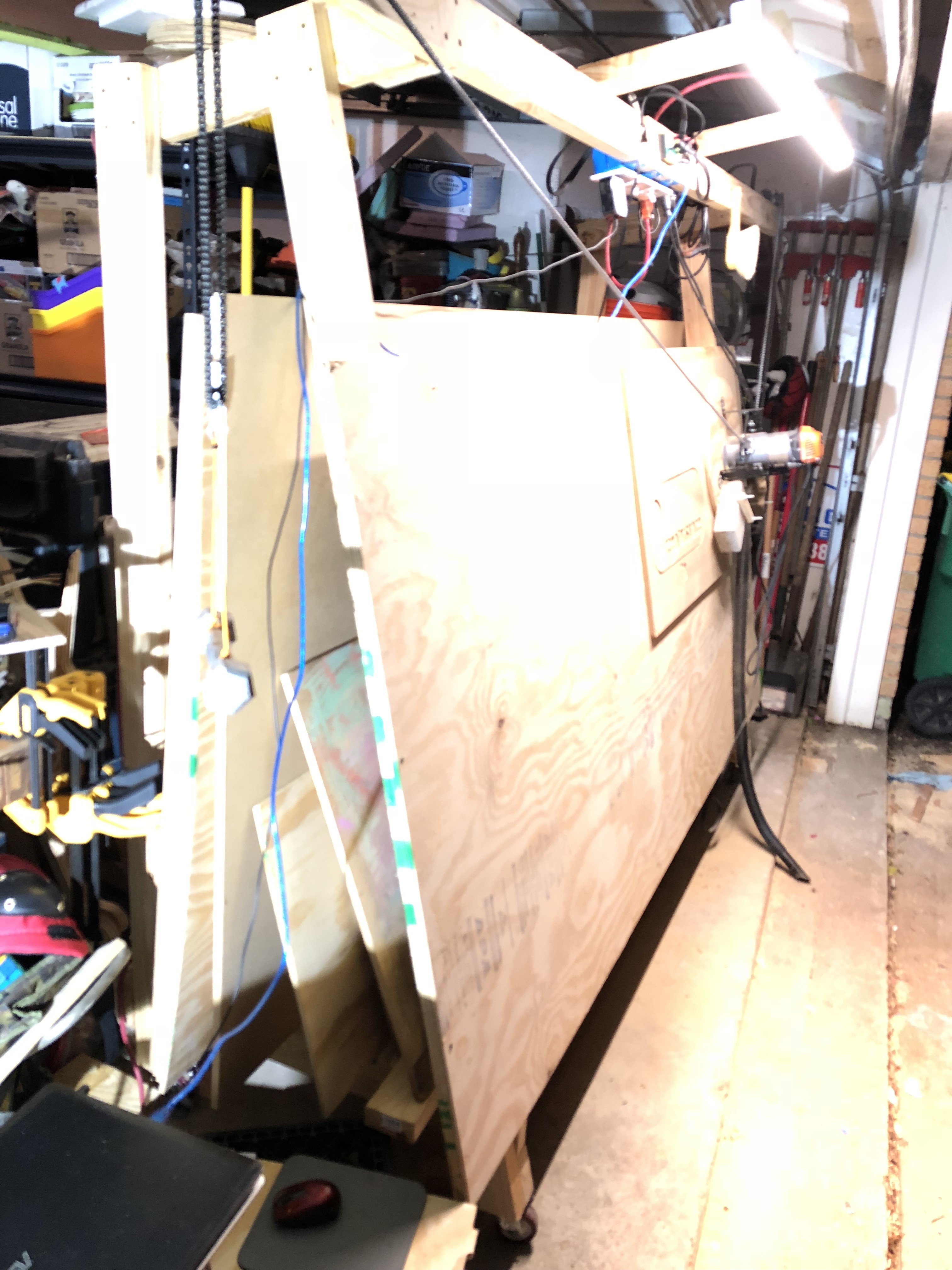

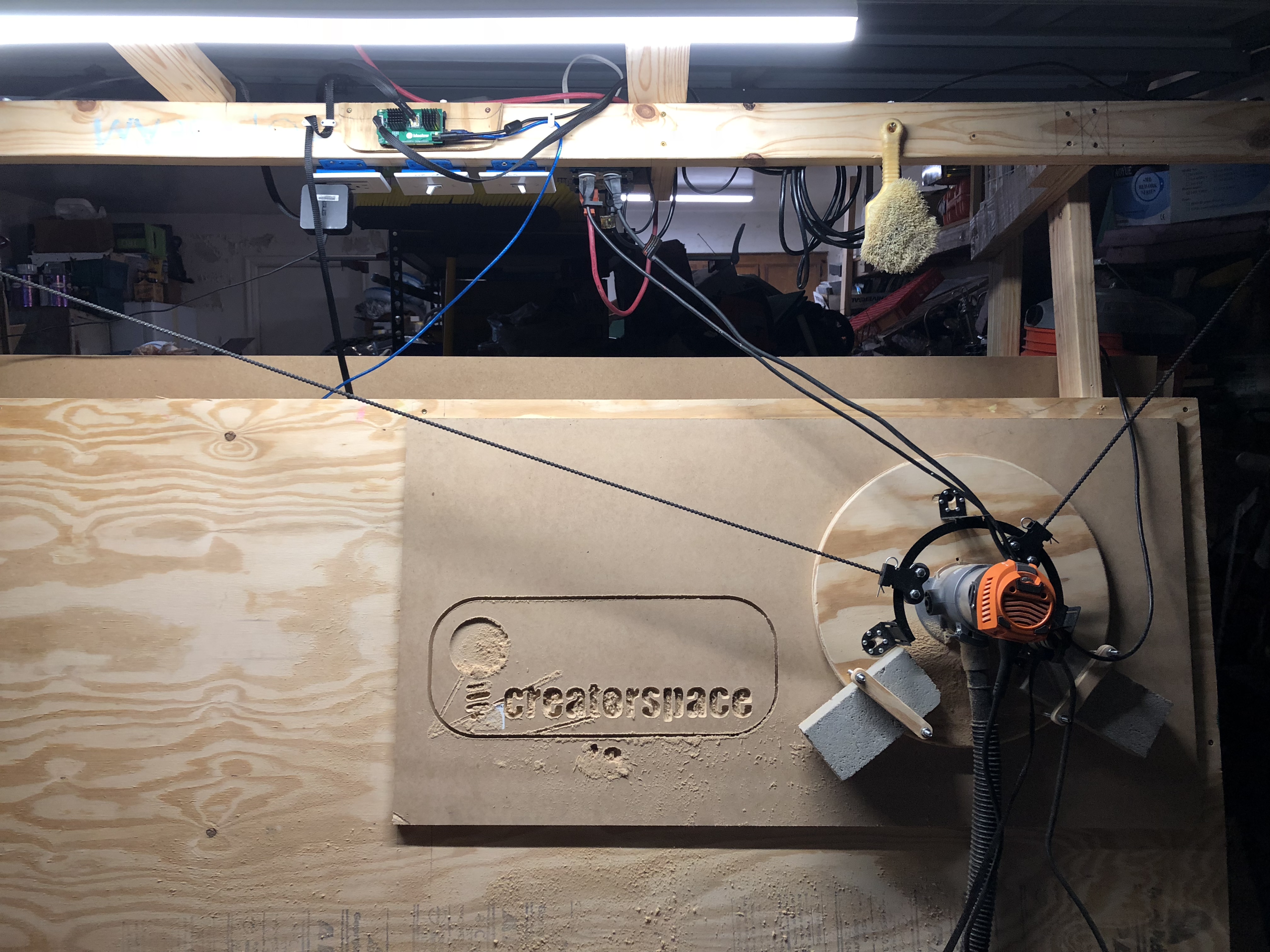

So, I finished my redesign of the default frame with panel cart. I added switches and outlets. The left switch is for the light and Arduino/Maslow boards. The right is for the router/shopvac. I have one plug on the far left that’s always powered. It also has two USB ports built in. I plan to use one for a Raspberry Pi, once I figure out how to get it to work. I’ll be adding an arm and VESA mount for a 13” HDMI TV I have for the MasPi (@bar should trademark that)
Lessons learned:
  1. Just because you modeled it, doesn’t mean you built it right. (The old, measure twice, cut once thing)
  2. I really dislike MDF.
  3. Being familiar with electronics is not the same as being familiar with wiring electrical outlets. (Blow the breaker with the WiFi and everyone hates you, especially the six year old with a Netflix addiction.)
  4. Troubleshooting is more valuable than anything.
  5. Just because you measured the plywood thickness, doesn’t mean your program will cut through the MDF.
  6. A well calibrated machine will do wonders.
Ryan.

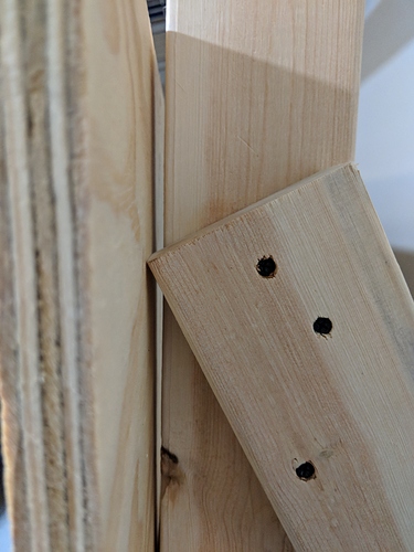

So one problem I had with the new stock frame design was that the upper corner of the back legs protruded beyond the front plane of the frame
, such that it would warp the material being cut. I used a hand saw to trim the corner flush, but it makes me wonder if I did something wrong? Some of the early photos show this corner protruding above the 4 ft. material height, so that its not a problem. Perhaps the dimensions got changed along the way? If its not just me, then its something worth solving in the design – perhaps cutting the corner off when cutting the pieces.
One other small note for the instructions was that I mounted the top cross bar backwards, Maybe it would be worth noting that between step 8 and 9, the frame is flipped over so that the top bar protrudes forward. Its clear in the pictures when you know what to look for, but when I was doing it for the first time, I got it wrong and had to reverse it (doh!). No big deal though.
Other than these two small notes, the frame went together easily and seems to be solid so far!
working great otherwise.
you either need to trim the corner off (as you did) or put the screw near the
front so it doesn’t swing forward.
trimming the corner off is the easiest thing as far as I’m concerned.

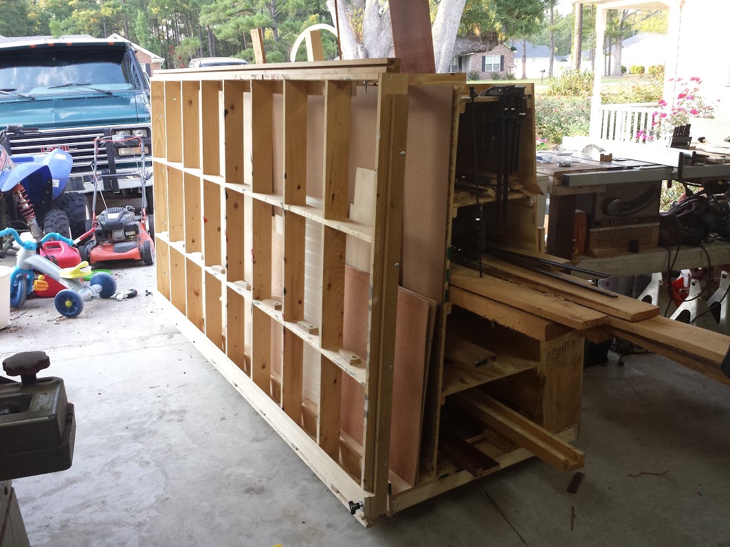

I am thinking of building a Maslow frame onto this storage rack in place of the panel saw. I’m not sure what design to go with but like the top beam. This rack is already 8’ long with lumber hanging out both ends so 12’ should be workable. I might have to beef up the casters for the extra weight but it will be mobile, provide storage and is pretty damn solid. I just ordered my kit for January shipping.
I’m also looking at the idea of an MDF spoilboard based on what they use for a bed type CNC. The idea being that you have places to clamp material or use bench dog style holding jigs. This is from http://www.cncrouterparts.com/cnc-spoilboard-p-425.html and they have Fusion 360 file with parametric measurments. Any thoughts? I wont get my Maslow until January so I have lots of time to plan projects…
