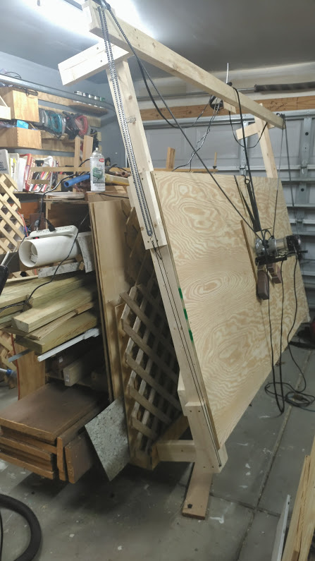

Well the Maslow box arrived on Thursday and Saturdays ended with a calibration run. Here is the new design Maslow Frame mounted on the Lumber Storage Cart in place of the panel saw (please ignore the mess…). I went with a 10’ beem as I am out of room in the garage/shop. Ive got the Sketchup file with Cutlist file if anyone wants it.
Update: With temporary square sled and 2 calibration runs I calculated a Benchmark Score of 0.456:0.34 !!! Now if I make the Meticulous Z Axis sled like I plan I will probably mess it up…

I’ve uploaded the Sketchup file and the cutlist to my github account. Feel free to do what you want with them. This is by no means my creation! I found the sheet goods cart in a woodworking magazine (ShopNotes Issue #55, Pg. 24) and the maslow frame from this forum community. Be forewarned! The storage cart holds A LOT of cutoff scraps…
https://github.com/jmiele4/Woodworking-Share
