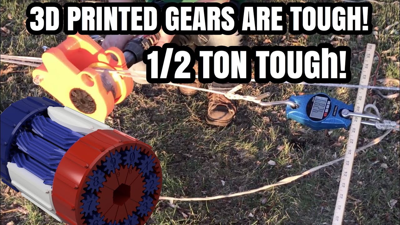

I found a 3d printed gearbox that they drove with a battery powered drill and gave a ~150:1 gear ratio and topped out at around 1000lb of force. I think something along those lines (not quite as beefy) that is driven by a belt drive to give it another step of reduction could work very well as the winch, I’m just trying to figure out a good way to get a position sensor. Part of me is thinking that I should just have the sensor as a separate drum that the line goes around (either a partial wrap across the top and around to lead off, or a full + partial wrap to give a better bite on the drum). The separate drum would make the sensor trivial as the bearings can be any size to incorporate the sensor, it can be just large enough to not damage the rotor (~3" for a 3/16-1/8" cable) and it would mean that the physical dimensions of the winch and the possibility of the line wrapping on top of other line doesn’t matter.
