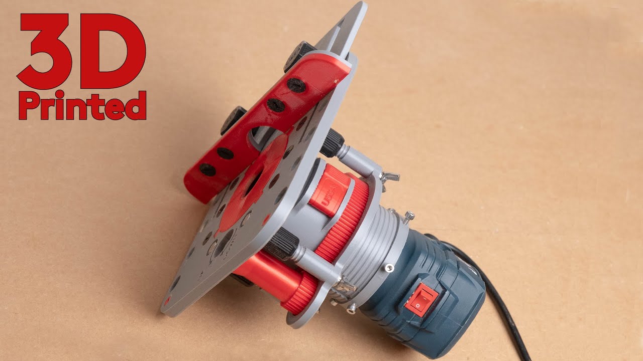

This youtube channel is doing very interesting things with 3d printed parts. Here is a video on making a router lift, which could be pretty trivially adapted to a maslow sled
a few techniques that he is using that are interesting are the assembly from multiple parts, and the reinforcement of parts with internal bolts threaded in to the parts.
He also does parts for a 3 legged stool strong enough to sit on with some interesting joinery
