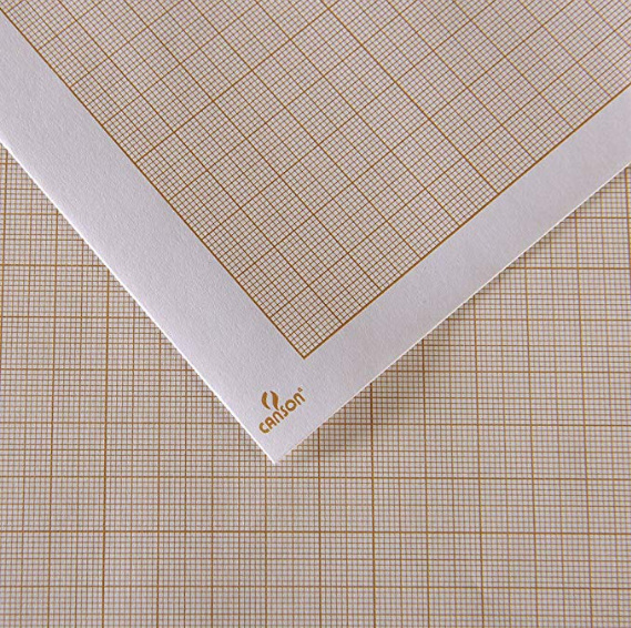

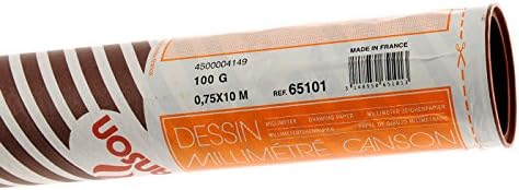

Millimetre paper 0.75 x 10m ?
Grid paper, even in banner form, seems harder to use than continuous feed paper. You’d have to trim off the borders if you want to overlap the sheets, and after trimming it’s not visually easy to evaluate alignment at a distance due to the fineness of the grid. The tractor paper holes are easier to align, and although there might be a hole only every half-inch, the interval is expected to be very precise and serves the distance-measuring purpose with less complexity.
Up to DIN A2 you get the ‘see through’ version, which is far more precise to align then holes, from my perspective. Not sure if that exists in the above mentioned roll (will search). 3 horizontal paths over the sheet (if it exists), aligned in height by eye and horizontal with a laser level, seems for me more solid.
The width → how many layers, is my concern.
I’m not sure if you get those tractor papers without the perforation to tear the sides off and the sheets apart. I’m by no means an expert, just would expect that the perforation has the chance to introduce an unwanted stretch.
If what you are talking about is the ‘needle printer paper’ i’m dealing with it regularly. Couple of years back it happened that i’ve torn my receipt apart either by separating the pages or taking the sides off. What i see now (in this remote region), it almost comes off by itself. It seemed to turned very thin. For sure there are options for that, admit.

How wide and long is this transparent one? Wide transparent accurate grid?

remember you are trying to get sub-mm accuracy, if you are having to manually
align different pieces of paper, you won’t get that.
@Gero The millimeter paper, even if translucent vellum-like material, would still be more difficult to align IMO. The grid lines, assuming accuracy even over long distances, still have a thickness on each printed line that might vary. The line thickness could vary, for sure it varies if you have heavier printed centimeter boundaries. Vellum print can be abraded or soiled, making it harder to read. I’m most concerned about global sourcing and shipping of metric niche use paper in tubular form. A crease or kink in vellum would make it hard to keep it flat and accurate. I hear your pain about the thin NCR multipart paper, that stuff tears like crazy and the pin feed holes are often just roughly bashed through. It’d need to be normal computer printer paper, or better yet, cardstock.
@dlang If continuous feed paper (AKA tractor/pin/needle feed paper) is used, you don’t need to align many different squares. Just pay out eight sheets from the box of accordion folded paper, lay it flat, and then overlap four more long strips just like it above/below. You’ll get coverage across most of the work area. Heavier weight paper helps but is not necessary. If you want absolute repeatability, then level and tape your top row, then pilot a few same-size holes exactly through the tractor feed and insert a well-fitting pin, dowel or rod into each hole. I bet four nails holding up eight sheets would be fine without gravity reaming tracks holes. Hang the next sheet strip on the same rods sticking out of the lower edge of the top strip. Align it perfectly and gently tack/staple it down. Repeat with more pins, strips on down the work area. After everything is stapled and taped, remove your pins/dowels and put them away until you need them next. If you goof and tear or ream the paper, just get out some more.

Never tried, just guessing, that round holes would be better to recognise, due to the lowest circumference.
If i ever get it up and running, will test both.
Would have not thought about the mm paper without you.
Thinking out of the box can have sweet fruits.
Thank you for the inspiration.

The challenge with grid paper is figuring out where you are when every spot on the grid looks like every other spot.
