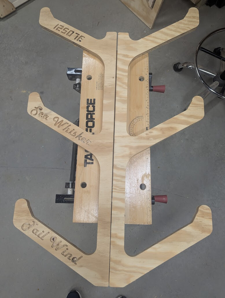

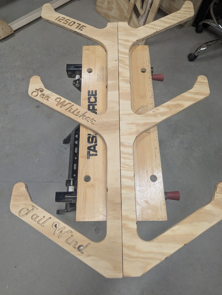

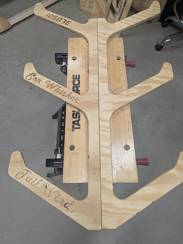

This was my first time working with lettering. I both cut the letters too deep, 5mm, and had trouble with voids in the sanded plywood. Several of the smaller bits - inside of 8, S, and d - for example broke off.
A sharp chisel removed the tabs used to hold the pieces in place. I didn’t worry about sanding them.
Because in the next step I used a round over bit on all edges, but the straight edge that would be against the wall.

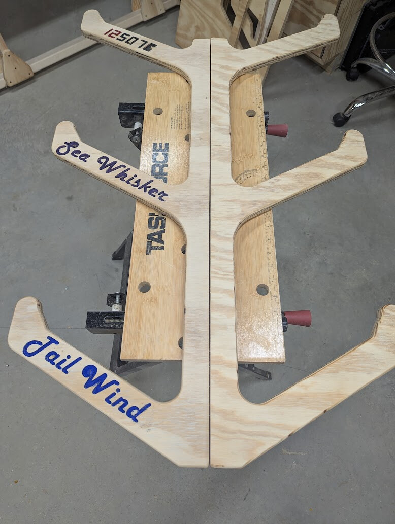

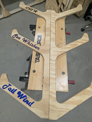

I painted the sail numbers and boat names with acrylic paint that was on hand. The blue was both gloopy and had a helper.
A random orbit sander with 220 cleaned up the faces and any wayward paint.

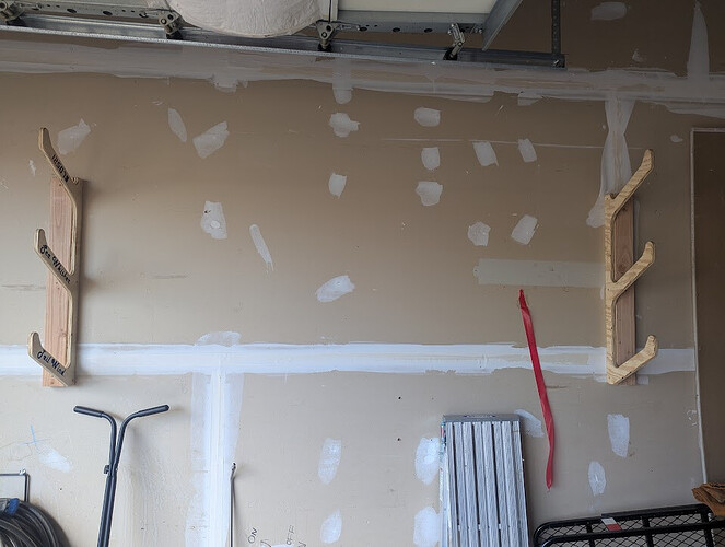

Each rack was glued and screwed to the edge of a 2x4 that would be screwed to wall studs in the garage.

These are spectacular! I love the mix of cutting and engraving text :smiley:
Thank you. I was thinking that when I get a z print working it might be good to try again with a v bit for the lettering if I can find a good way to generate center lines to trace.
