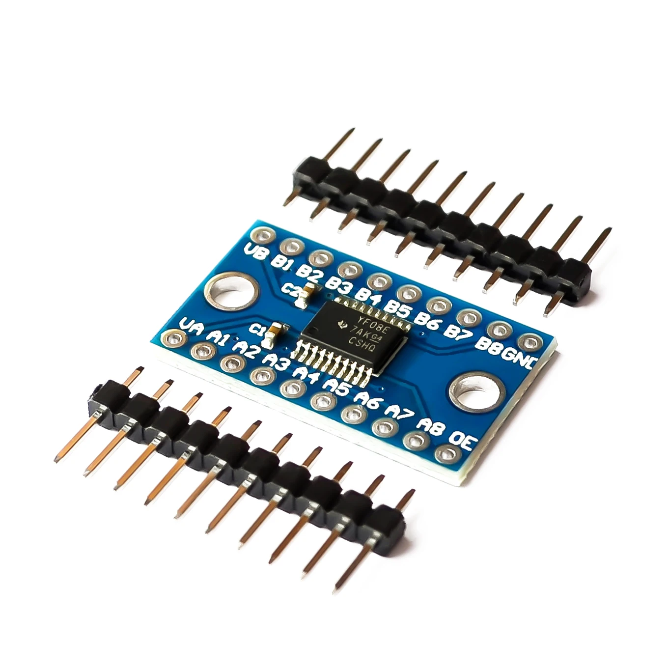

could you make a version of these that will work with the Due (including an
eeprom and level converters between the existing shield connections and the
arduino)
something like these chips:
ideally, have a pingout that matches a due, and a place where a ESP32 could be
soldered on. :slight_smile:
but even if you don’t make it have a nice pinout for any particular processor,
just having a board that we know will work well at 3.3v would be very valuable.
