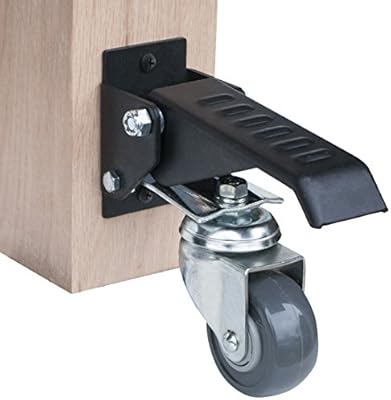

These wheels (not drawn) will be used:

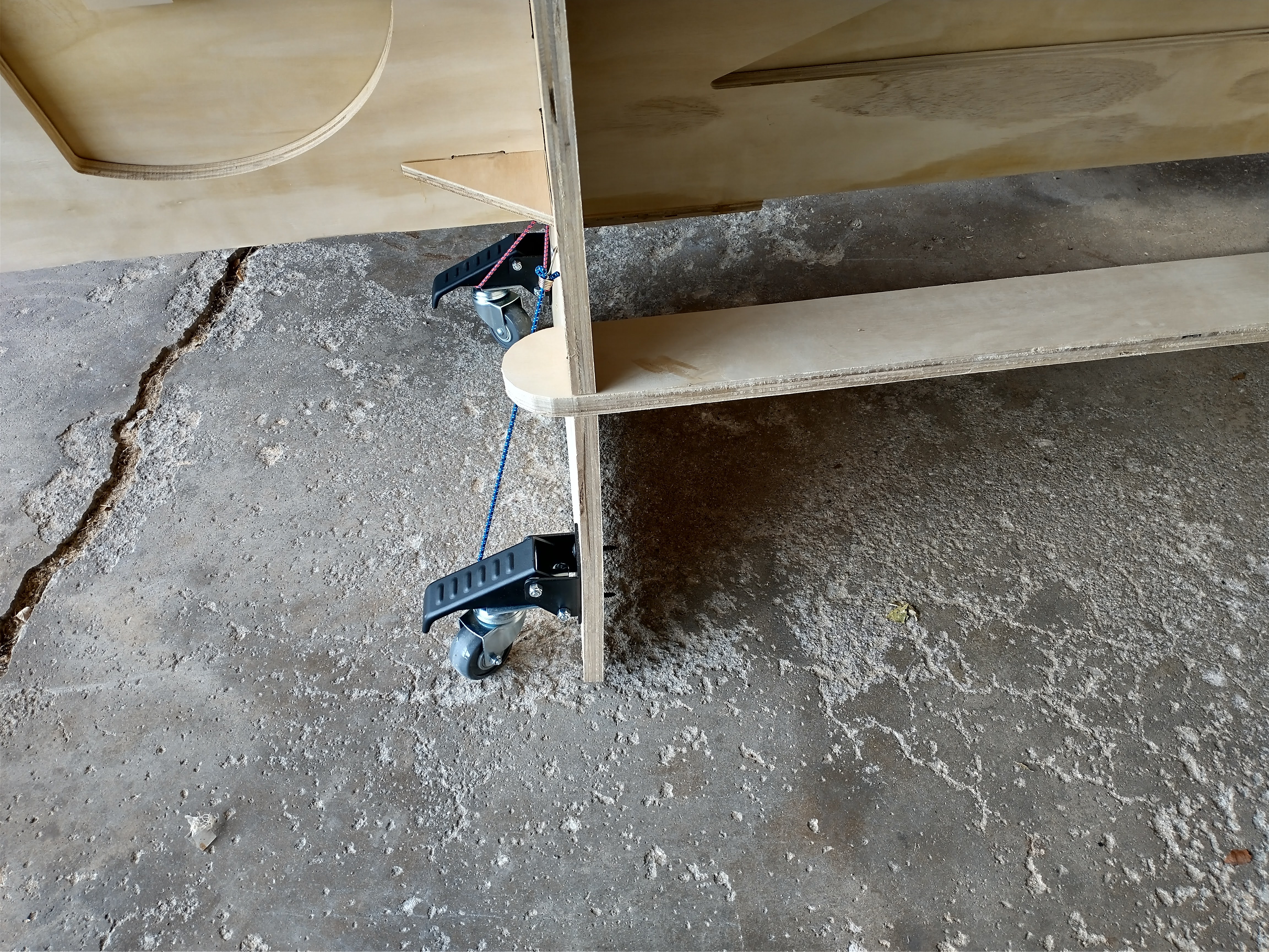

Got it cut over the weekend and I received plenty of plywood to test it out with.
Overall I’m happy with the base dimensions and angle. On the ground it’s quite stable and leaning against the wall works well. When it’s empty it rolls around and stores quite nicely. Under load things get quite sketchy when putting it up on the wheels…
The wheels are off center and bend the plywood quite noticeably. With the wheels at the odd angle they also don’t rotate properly making the whole setup hard to move under load.
With this much weight the wheels are also just hard to lock in place.
I’m going to redesign with the following:
  • Add more vertical support struts to prevent bending
  • Second bar to lock wings?
  • Use normal rotating castors in the back. These will be permanently mounted ones, not the flip up ones currently used. This will reduce the offset to help with the bending.
  • Add large, fixed front wheels with a reliable locking mechanism to replace the front curve.
    • These should roll normally. Before flipping forward they will be locked in place to act like the current curve in use.
    • The locking mechanism must not fail or it will drop the load. I’m thinking of building a form of spoked wheel that I can lock by putting a steel bar through.

I found a simple short term fix: double up on the wheels. Now it sits and rolls without feeling like it’s going to collapse. I also found that tightening the bottom bolt so they stay up when you put them up makes the whole thing a lot easier to use.
Now I can finally put the cars back in the garage again.
