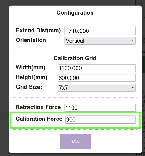

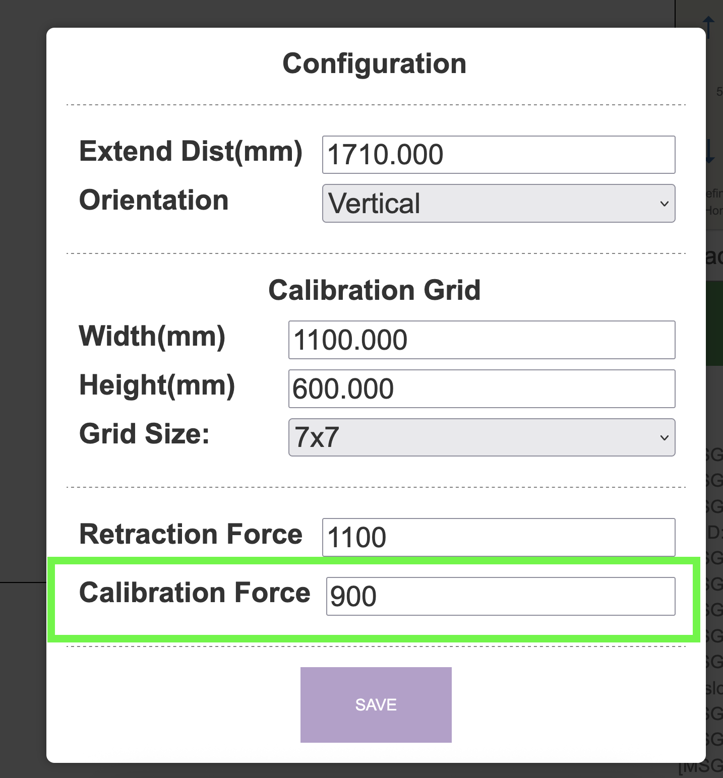

Hmmm do you still have your maslow.yaml file from before the update?
This should have reset everything to exactly how it was before the update.
Another thing which might have messed things up is that the default amount of force went down:
That number used to be 1200 and increasing it back to 1200 might help your machine find a better result from calibration.
