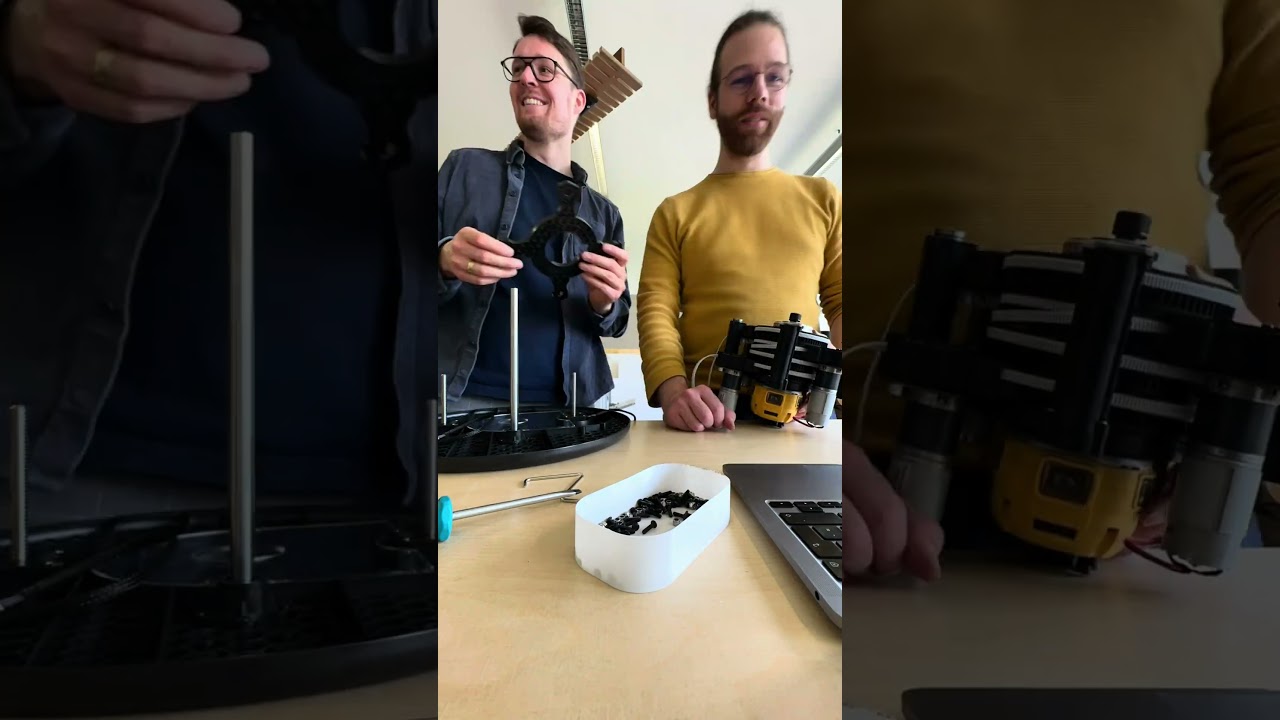

We already had a lot of fun building the machine: Maslow CNC assembly

After that, however, I raised the Z axis too high. When the nut reached the top limit of the screws, it couldn’t move further and began slipping—one motor turn resulted in no vertical motion, just spinning. I’m not sure what the correct term is for this kind of issue, but the machine thought it was much higher than it actually could be.
As a result, the belts were completely loose, and when we tried to retract them, one belt was retracted incorrectly and lost a few teeth.
We took everything apart and shortened the belt, thinking that the measurements Maslow takes during calibration are always relative to the point at which all belts are retracted (?), so it should also work with a shorter belt, right?
Unfortunately, we haven’t been able to calibrate it since then. The fitness level always remains too low.
Does anyone have any idea what we’re doing wrong?
