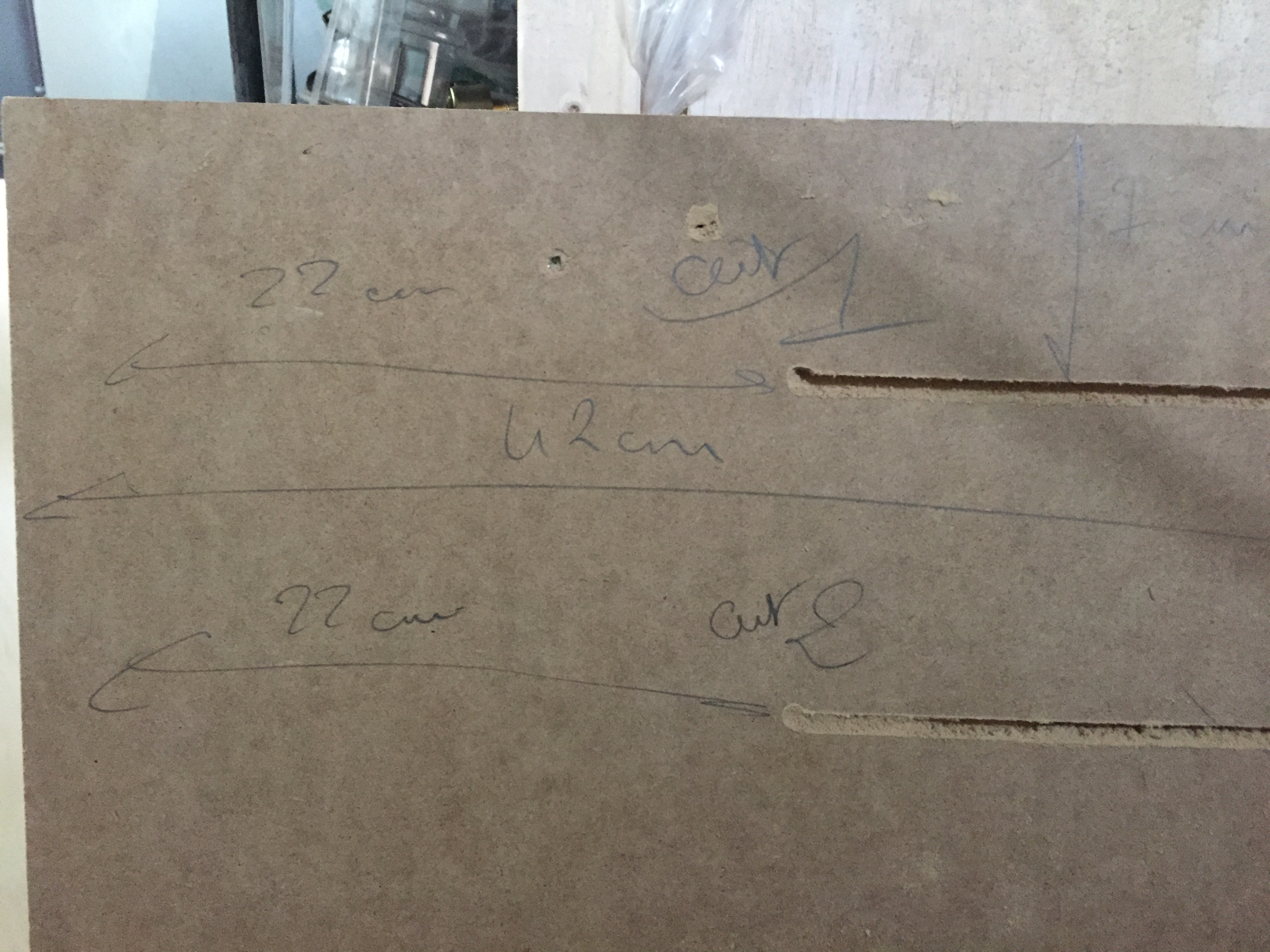

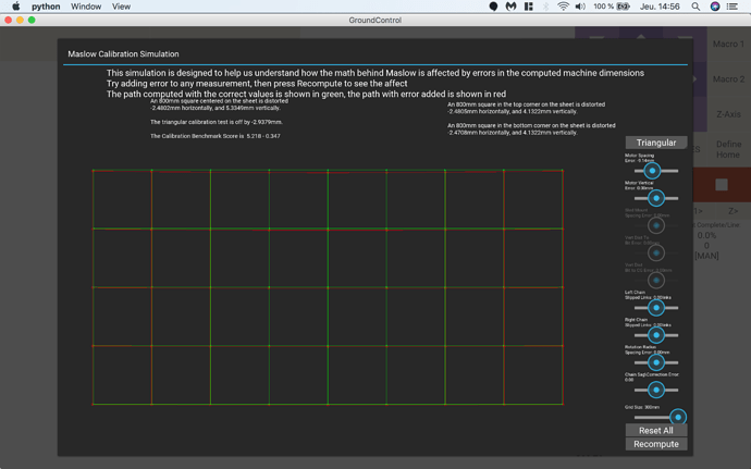

Slight curve when cutting inside 2 inches from the top and the bottom of the sheet
So i’ve

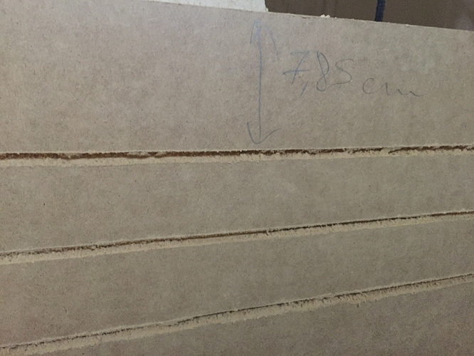

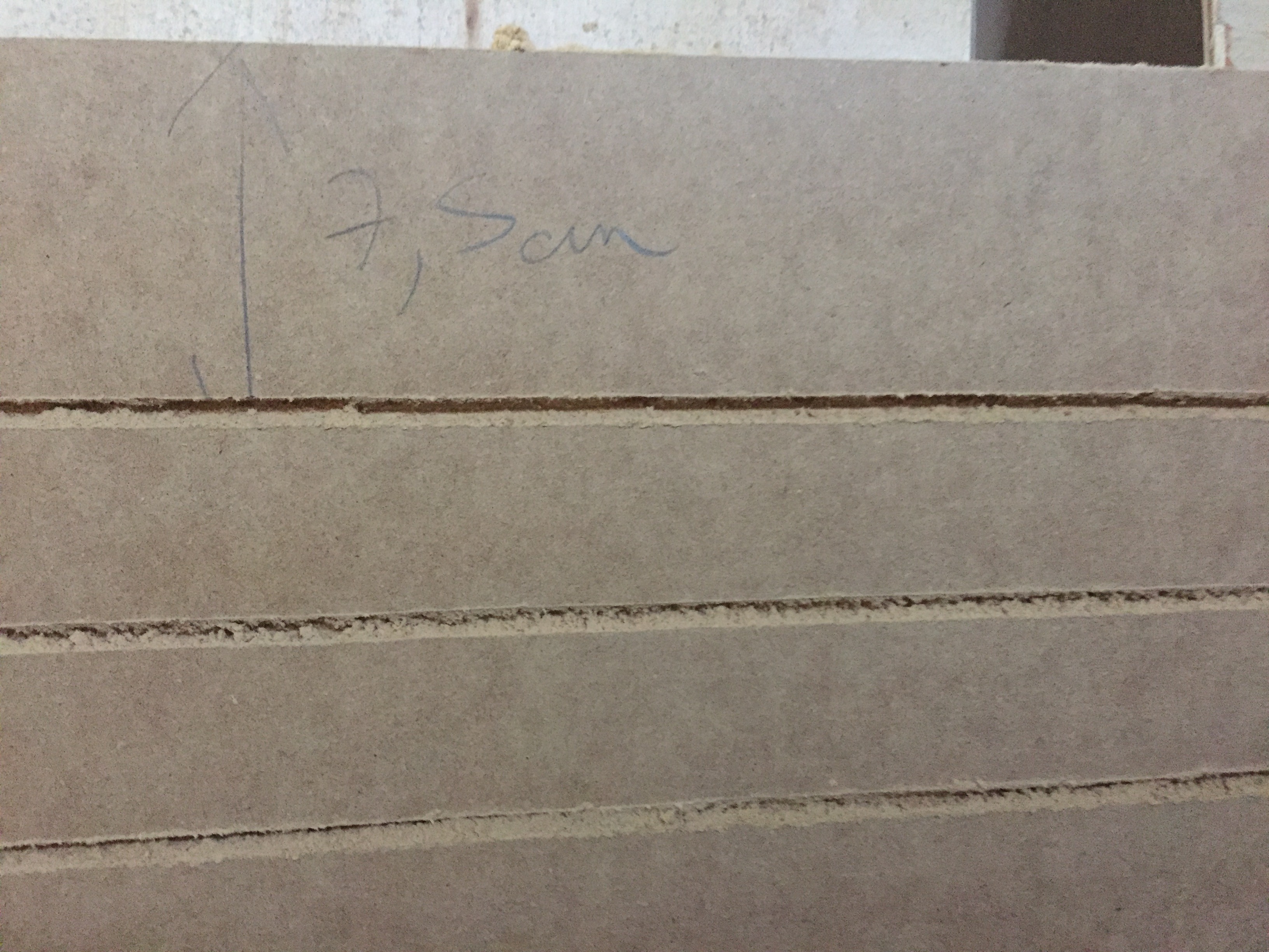

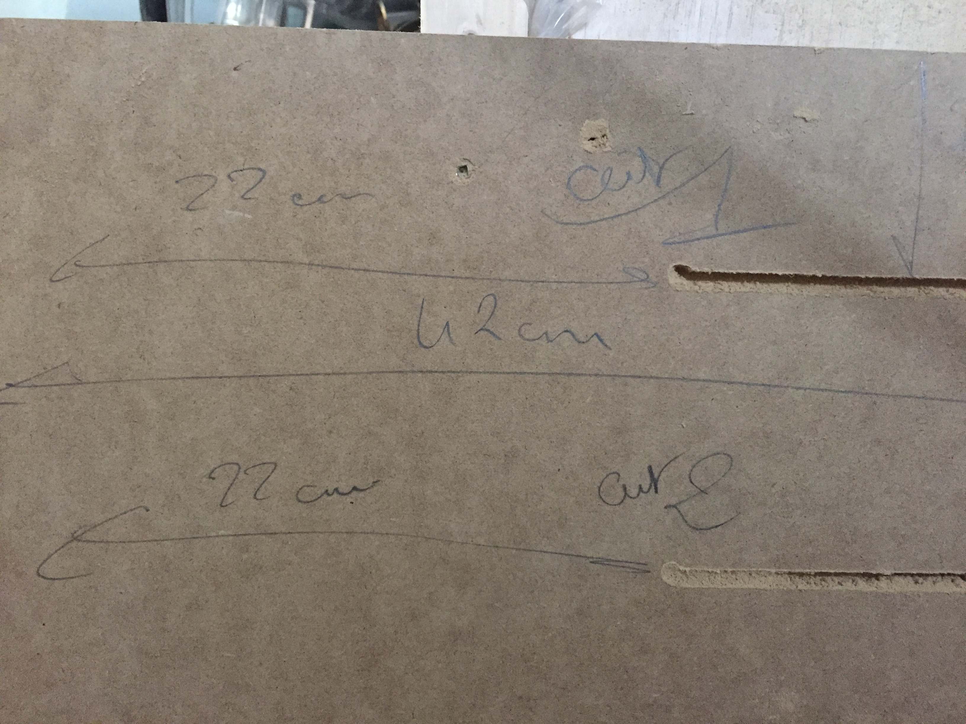

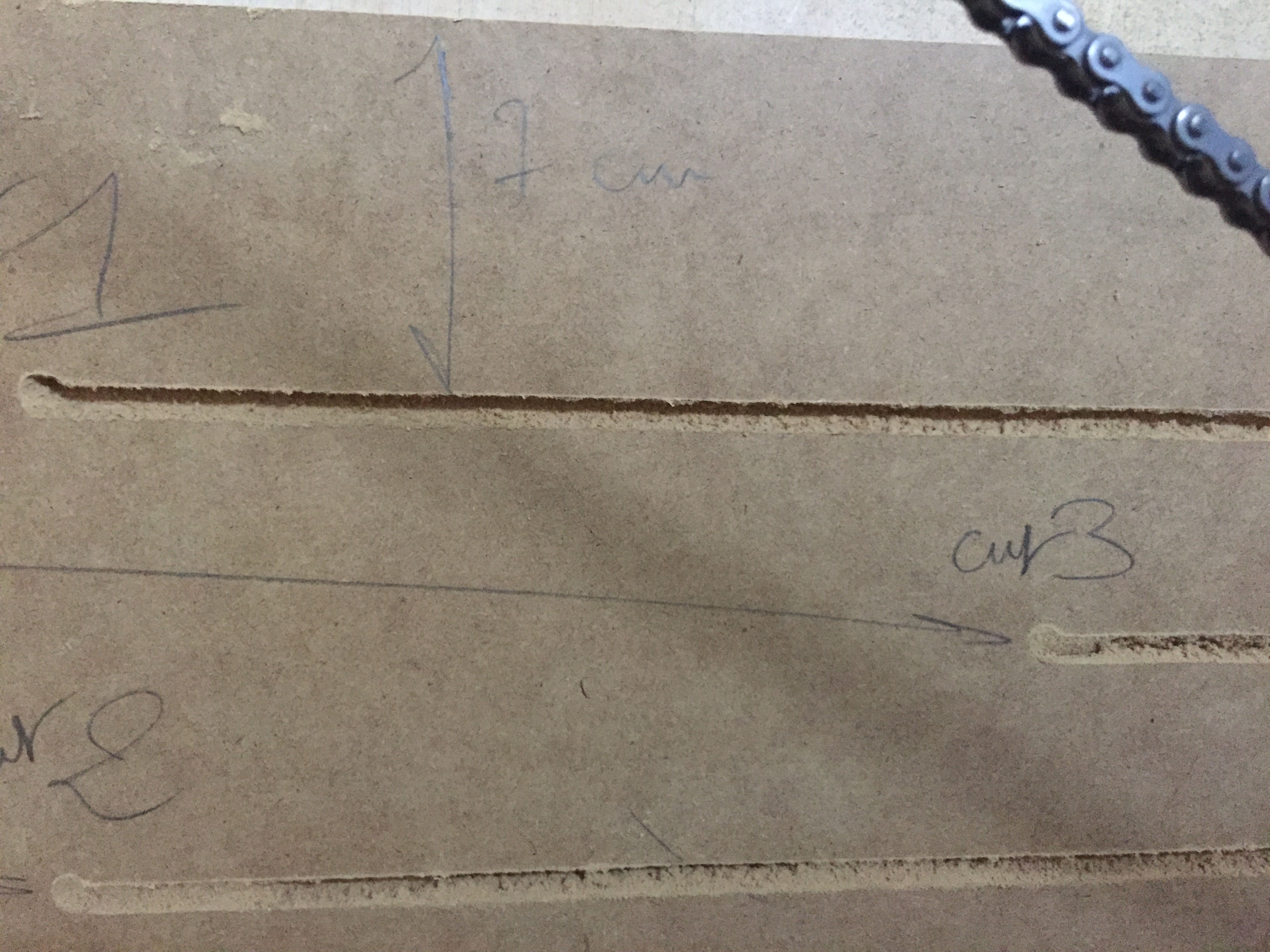

As you can see, the slight curve is visible on all 3 cuts from the left to the right. The same thing is happening if I cut to the far right (not on the picture) the distance of around 1cm of space between the highest and the lowest point still occurs on both side of the work area.
If I work at 42 cm from each side it is not that bad a few mm off only.
But I loose a lot a workspace / wood.
I am a bit puzzled and I don’t see what the solution could be.

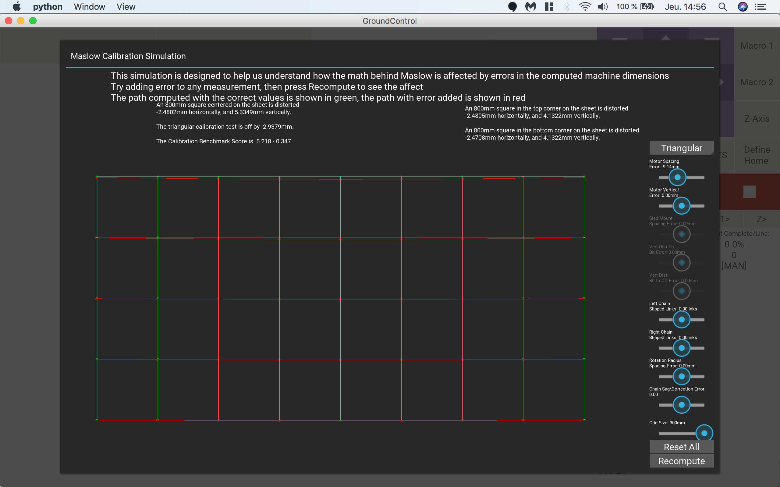

The simulator will show you which variables can cause that kind of behavior, I would recommend playing around with it. You can launch the calibration simulator by clicking Actions -> Advanced -> Simulation
I suspect mine would do the same if I did the cuts you did. I think for my case its related to an issue with the distance between motors measurement.
here is what I see on the simulation
Try playing with the sliders to the right to introduce simulated error into one of the measurements. It will let you see which measurements could be off to introduce that type of error
ok so the motor spacing seems to be an issue as @madgrizzle explained,
When I’ve tried to set a new distance for the motors manually, I was warned by a message that my chain length was incorrect. And then when I’ve tried to cut it goes worst on the cut.
How can I be sure that the change of Distance between motors won’t affect other parameters which seems fine apparently?
Have you manually measured the distance between your motors and compared it to what maslow measures?
yes I’ve found 3010mm manually with the sled on From upper tooth left sprocket to upper tooth right sprocket and maslow find 3004.93mm once the chain tightened during the calibration. Maybe I don’t measure on the right spot?

I have also noticed that it ca come from the rotation radius error on the simulation
Rotation radius gets adjusted during calibration (along with the vertical offset and chain sag values). The distance between motors is never adjusted once the machine measures it. The rotation radius value compensates for the error to some degree, but not completely.

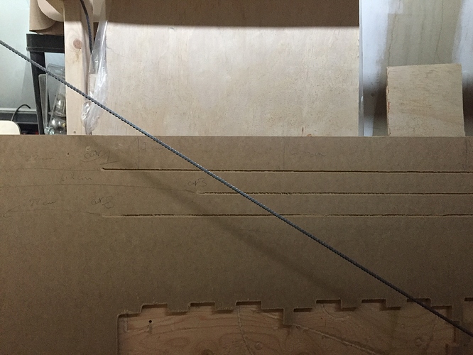

I’ve just did it twice in a row, without touching the distance between the motors. It is better I am only of 0.6 mm of difference between the left and the middle of the curve instead of 1cm
After many tries… here is the process that lead me to have the smallest error : like that I go from 1cm of error at the middle of the curve to 2.8mm of error at the middle of the curve.

This is the classic symptom of the motors not keeping up. The cut droops down a bit and then at the very end hooks up to where it should be
If you slow down, it should clear up.
This can be caused by a power supply that’s not quite powerful enough to keep the motors going (if you put a meter on it, you should see it’s voltage dip a bit, especially towards the end of the cut)
The making the sled a little lighter will help.
raising the top beam a little higher from the workpiece will help
both of these will require re-calibration as the machine is changing.
Unfortunantly, this is a case of the machine not behaving as the firmware is trying to tell it to, so it won’t show up in the simulator.
