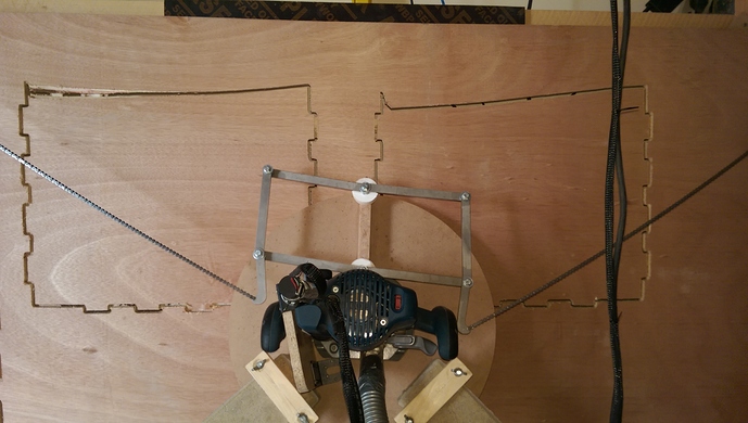

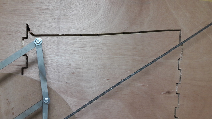

Any idea why a straight line at the the top would sag down, to spike up at the end?
FW & GC 1.07.
The gcode has a clear vertical XY coordinate to the left (cut counter-clockwise). .nc and log are in the .zip leftcut.zip (235.2 KB)
Part 2 had 3 different runs on this error for each pass (seen in second ply pic), first a higher error, then a lower error, then the final error between the 2 others. On part 3 the error was constant with all 3 passes. It seems like with the left move the motors are not coordinated.
Any input welcome.

I cut part 2 out of the gcode and made it a single piece.
Same thing happens, this time a bit flatter curve than the past.
Question: Would I find a ā€˜stall’ message in the log or terminal?
I’m surely stretching the limits on what the Maslow can lift and the cut is at the top, so I’m wondering.

Looks like the left hand chain has jumped the teeth on the sprocket.
Any snagging on the chain links? , are the links free to move?,
try calibrating the chain length but have the both ends free, allowing the chain to move freely,
once chain is finished calibrating the length , attach the chain at the motor mount and sledge,
as if the chain binds on the links it forces a jump
also add some repair washers to the guide pulley to keep the chain running true from the sprockets
I know that sound very well. I was with the Maslow all the time, no chain jumps, plus I have 3 surrounding cuts in 3 passes that I can put ruler on. They are at 90°.
I agree, this doesn’t seem like a chain skip, otherwise we would be seeing similar issues across the entire bed. It could be a kinematics problem, but then I wouldn’t expect it to ride up to the proper level at the end of the cut. My first guess would be a motor stall/power issue, especially if it’s at the top of the board, but didn’t see any messages about it. Very strange indeed.
Since I’ll not be able to test, lets agree that before 24 hours a new test was done with less weight. That should narrow things down. Thanks for the heads up guys. Same place, same time tomorrow :kissing_heart:

Part 2 has 3 passes, first is the top cut, second the lowest and third in the middle. Sticking and releasing would be an explanation for that.
Part 3 does all 3 passes at the same cut and error. I would expect a sticking kit to be more random.

To help diagnose the problem, run it again without a router bit and the router turned off (that way the bit is not in play). I’d wiggle the sled a bit as it progresses from right to left to see if that changes anything. Just a thought as it would help eliminate linkage kit as the source of the problem… and would be safer as the router is off.
I ran it twice yesterday, similar to what you wrote.
Weird thing is, the velocity is around 30 then drops to 14-15 when the arc begins.
if the feed rate is reduced, does it still arc?
