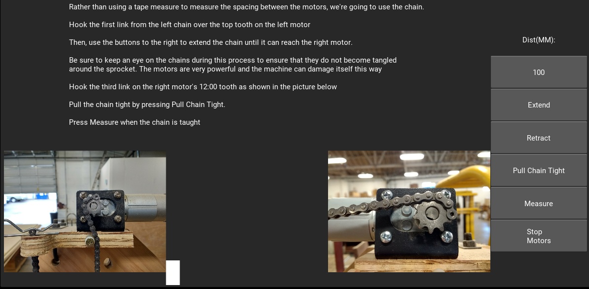

screen -6 screen shot of left motor show chain wrapping over gear from the left side, bur when I start the routine the gear moves counter-clockwise and chain falls off. I moved chain to wrap from the right side and complete the measurement test.

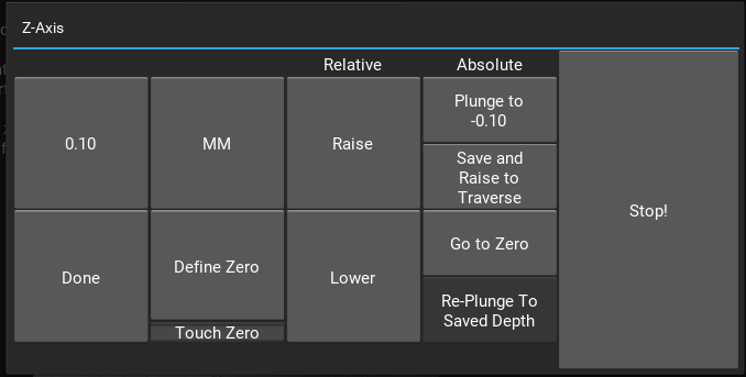

The Z-Axis page calibration page moves the sled motors instead of the z-Axis. When I run the Test Motors and Encoders from the Action menu the left, right and z motors all move up and down.
I tested on raspberry pi and also Ubuntu. Any idea why the sled motors move instead of the Z-axis?
I thought we still did the measurement the same way regardless of chain over top or bottom (someone correct me if I’m wrong). I know the calibration routine spools out a negative amount of chain with the bottom configuration, but I assumed that because its in a bottom configuration, it would result in basically the same as a top configuration (motor turns clockwise).
If I’m right, its as if the arduino didn’t get the message that its in a bottom configuration.

Which motor moves (left or right, or both) when you use the z-axis page?
It was both motors. I’m going to re-baseline everything and start over with 1.10 GC and wiped eprom.

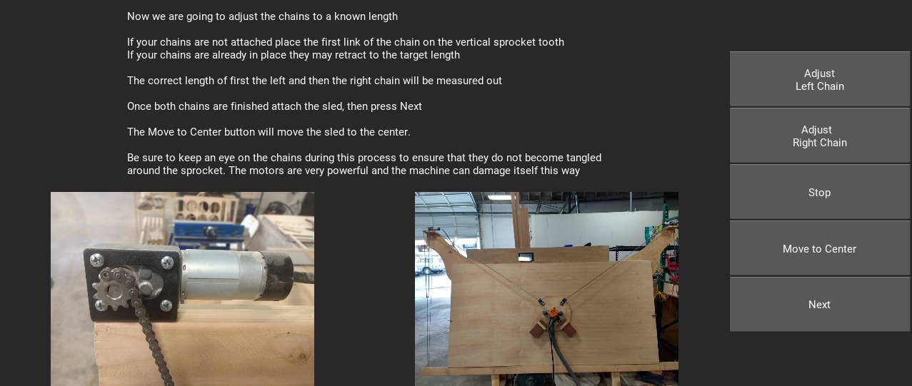

I had a similar issue when calibrating yesterday (GC 1.10). I didn’t understand the instructions when it came to “adjust chain”.
When you measure distance between motors, the left chain is already extended a known amount. So when you “adjust chain” it pulls the chain back to the correct dimension. My mistake was assuming I needed to reset the left chain to the first link. I kept taking the chain off the left and right sprocket and then resetting the first link on the left sprocket.
The right chain rotated correct and fed the correct amount. I was so frustrated when the left chain would rotate the “wrong” direction. My ignorance and inability to follow instructions are just some of the services I offer.

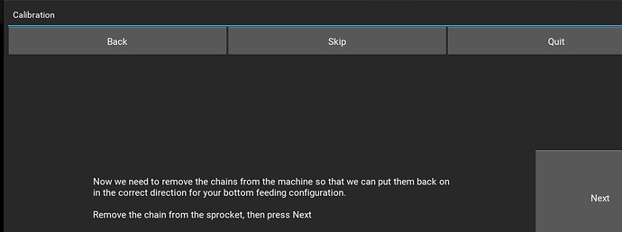

I did not have a chance to work on my Maslow today. But, I toggled thre the calibration steps and I guess this screen threw me off several steps before you reach the Adjust chain screen , It says to remove the chain. Seems counter intuitive to leave the chain on, as suggested, but I will try it, tomorrow.
I would also mention on the measure chain screen it shows chain wrapping on to the sprocket from the left on the left motor. When I hit measure the gear turns counterclockwise, so I re-did step with chain wrapping over from the right side of the gear.

Yeah, that sounds like a problem. I don’t think the motor should turn counterclockwise. It’s as if the controller thinks you are in a top configuration whereas GC thinks you are in a bottom configuration.
When you are in a top feed configuration, you do not reset the left chain. However, you will need to reset the chain for bottom feed configuration because the calibration routine for measuring distance between motors uses only a top feed configuration (to the best of my knowledge).

No, everthing seemed to work as planned until i came up to the the Z-axis zeroing. Ater measuring out both the left and right chains, I hit next as instructed on this screen.
When I got to the Z-Axis calibration, and went to lower the bit, it dropped the sled down instead.
