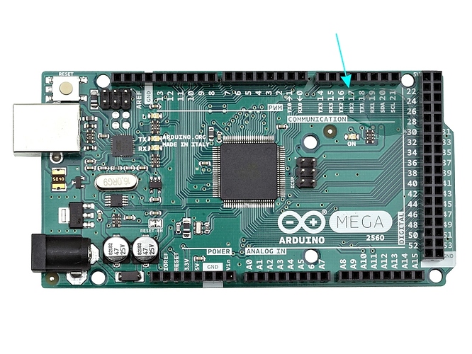

Spindle on (M3-4) no signal on D17 with shield v1.4b
I am trying to connect the wiring so the M3 or M4 will turn on the spindle. I have had the Maslow running flawlessly for over a month after working out some of the rf noise problems with USB signals. After getting that figured out, I attempted to work on the spindle on/off.
I have the v1.4b shield, for which I can’t find any documentation for Aux1-4. Every image/diagram I find is one which already has the labeled aux port through holes on the pcb. Mine has none, nor any markings. Through research, I’ve determined (assumed) that the arduino uses D17 for that signal.
I am running 1.26 of the software/firmware.
I have the Relay_High set for the spindle automation setting
When I check the voltage on pin 17 after the spindle is turned on, it floats about 600mV (same as before “spindle on” is issued). Originally I put an LED (with resistor) between pin 17 and ground hoping the led would light when the spindle was to be on. It never came on.
I have tried 2 different mega boards in case the was the problem. Both acted the same way.
I hope the solution is obvious to someone. If 17 isn’t the correct pin, please let me know. I also want to use D14 for the Z zero function, but that doesn’t work either. I’m assuming I did something silly because the wiring instructions are fairly clear, and I thought, easy to follow.
I’m resisting buying a new shield just to get the stenciled ports. I’ve attached the mega image with my pin 17 marked with a blue arrow so you can tell if I’ve assumed the incorrect pin.
Any suggestions appreciated!
Dave
Can you post a picture of your shied? The system.cpp in the Firmware identifies board until 1.3 and that is a TLE with AUX1 on pin 40 (line 218).
    //AUX pins
    aux1 = 40;
Kind regards, Gero
Edit: For refference
/Firmware-1.26/cnc_ctrl_v1/System.cpp:255: SpindlePowerControlPin = aux1; // output for controlling spindle power

GroundControl reports the shield found at start. Bet it will tell 1.3, so pin 40 is the better bet.

The TLE2506 originally designed by @blurfl started its life as v1.4 however, when support for this shield was merged to the official firmware, it identifies it as “PCB v1.3 TLE5206 Detected” in GC.
This decision was made to keep consecutive numbers on the board versions.
When we decided to produce this board we did a research and found that aux ports were not widely used, since we were focusing on safety upgrades, we decided not to include them for liability concerns.
At the time you bought it (January) we were the only ones selling the TLE2506 which was indeed the latest shield version compared to the old v1.2
Although our shields now include aux ports due to user’s request, unfortunately your board does not.

@gero is right, spindle is on Digital pin 40

Thanks for that information. I have verified the pin 40 does go hi and low with M3/M5 so now I can add my relay. I appreciate the help and clarification.
