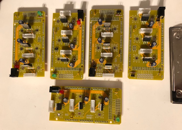

The Blue Smoke Herder Shield - AKA the New Maslow Shield (TLE5206)
For those keeping track -
IMG_7486
IMG_7489
IMG_7495
IMG_7498
V2 is Alive!!!
Ran several tests and a calibration cut. More info to follow, tomorrow I will be running some tests with the Maslow ring.

The point of this version of the shield is it’s more robust, has a huge set of heatsinks and it’s screwed to the driver. The current water cooling system would need to be redesigned and is un-needed in my opinion . I operate with none of the “improvements listed in the Ad” and have had no issues. I don’t even use the stock chain guide. I applaud any one that can solve there own problem, there is great initiative in what they are doing, but I disagree with the word Need.
There are 2 things that known to kill shields I’ve seen, The heat sinks falling off -
I use a coat hanger to resolve that in post 49 here:
The other is a motor jamming.
@Gero added a bigger power supply, doubled the AMPs - it ripped the Motor off the machine during tensioning in calibration.
I think were covered.
Just my 2 cents

For all interested I am waiting on the cost of the next batch of boards before we set prices. I expect to be able to release this information through my website on Wednesday in the user update letter.

Q1 -@Bee , Can you advise what type of connectors are being used for the Shield?
I am certain they are the same connectors as was used on the original Boards, but I don’t know what kind they were either… From the pictures, it looks like a 6-pin JST XH-series, but I can’t be sure.
I’d like to get a jump on making up cables for my Maslow while I wait for parts to arrive.
Q2 - Also - Do you recommend any Ferrite rings for knocking out noise on the cables or are people running fine without any filtering?
Thanks !
I can say how it will go but I’m meeting with a EU rep early next week.
I’m hoping they will take on EU production.
1A - XH-Series Connectors: 455-2271-ND 3 MP1-3
2A - I don’t know of anyone using Ferrite rings, they are cheep and easy, couldn’t hurt, but probably not needed.
