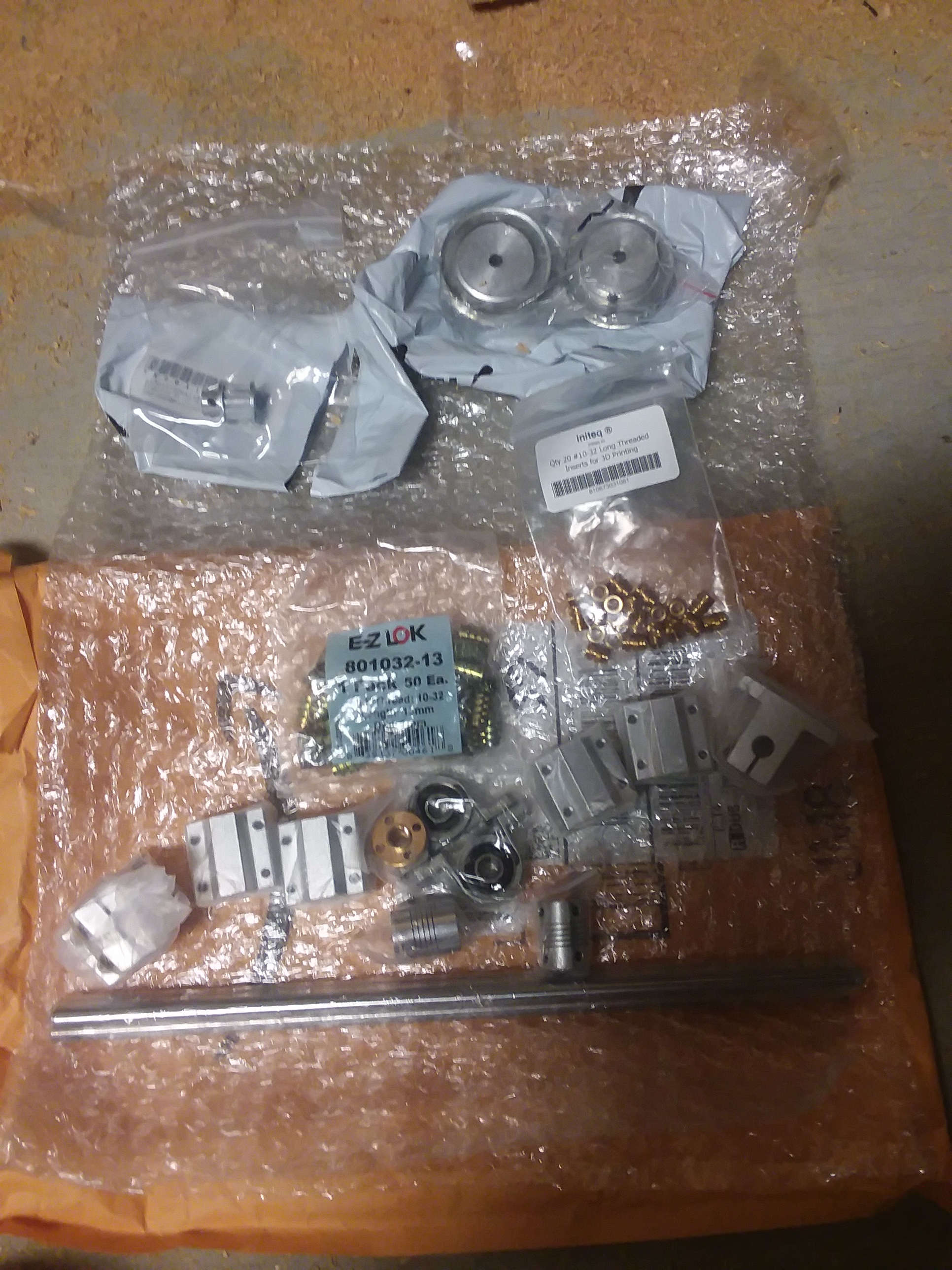

First order of parts came in. Looking forward to this project!
Woohoo! Can’t wait to see progress! I love the anticipation when I open a package of parts hahahah
