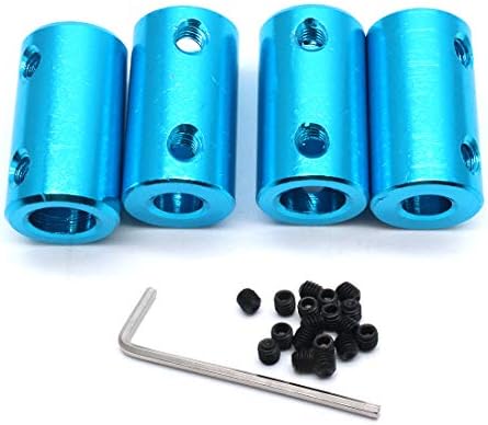

That 60T pulley looks like it has an 8mm bore. The z-axis motor has a 6mm shaft. A shim or spacer would be needed, but you might still end up with some wobble or the set screw may not bite and hold to the shaft.
Ah sh**. haha. Guess I’ll find out how it works once I get it assembled.
Get these:
and a 8mm brass rod. That was my solution.
